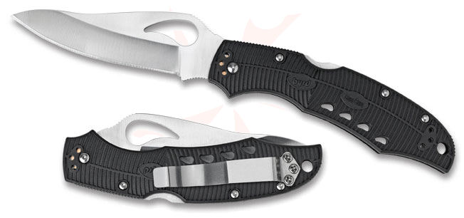

Below are stock photos of each knife.
Byrd Cara Cara...

Byrd Cara Cara...
