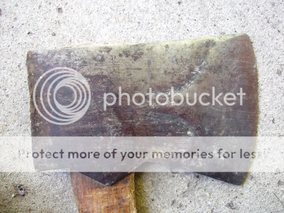

I do a lot of sustainable forestry in Ontario, and a lot of it involves cleaning overmature 100' tall Jack Pine, spruce, and poplar blowdowns in very rough terrain. I've brought a lot of vintage axes to do this over the years. These axes get a lot of use, and frankly, I'm underwhelmed by the penetration/efficiency I'm getting from them. I think it's time to move up to a competition style axe (4.5-5.5lb) with a practice/work grind tuned to knotty soft pine.
Can you guys give me some input on axe options, sources, and also where and how to have them ground to fly through knotty soft pine but stand up to long workdays? I'm looking at the Arvika 5-star, the Bolstad, and the Keech Timberman, and some vintage racing axes from down under.
Pics of my current workhorse, a ca. 1915 Charleston 5lb Kelly Perfect Jersey. Pics were taken by the seller before I lovingly rehabilitated it:
