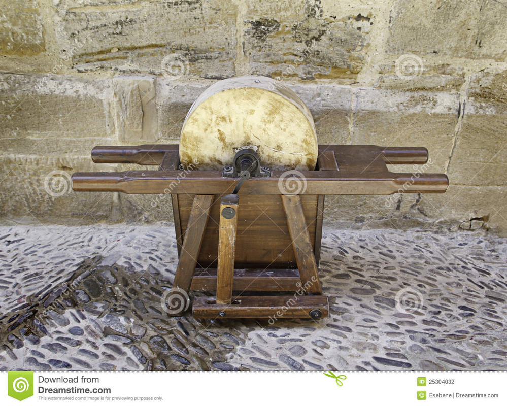

In southern Brazil, there were many. With a pedal, which were more efficient, and with cranks (as in the video), slow, but functional.

Gato, some stone wheels here have been converted to electric motor power. Usually belted down to run slow and water cooled, by tray or drip.
I find that I don’t grind as well on my foot powered stone, because pedaling it rocks my body back and forth somewhat. Probably different geometry could improve that, seems it was built for somebody shorter and I hunch over during use.
With my motor powered one I can focus better on tool positioning, but I need to rebuild the drip can. It rotates at about 90 rpm smoothly.
