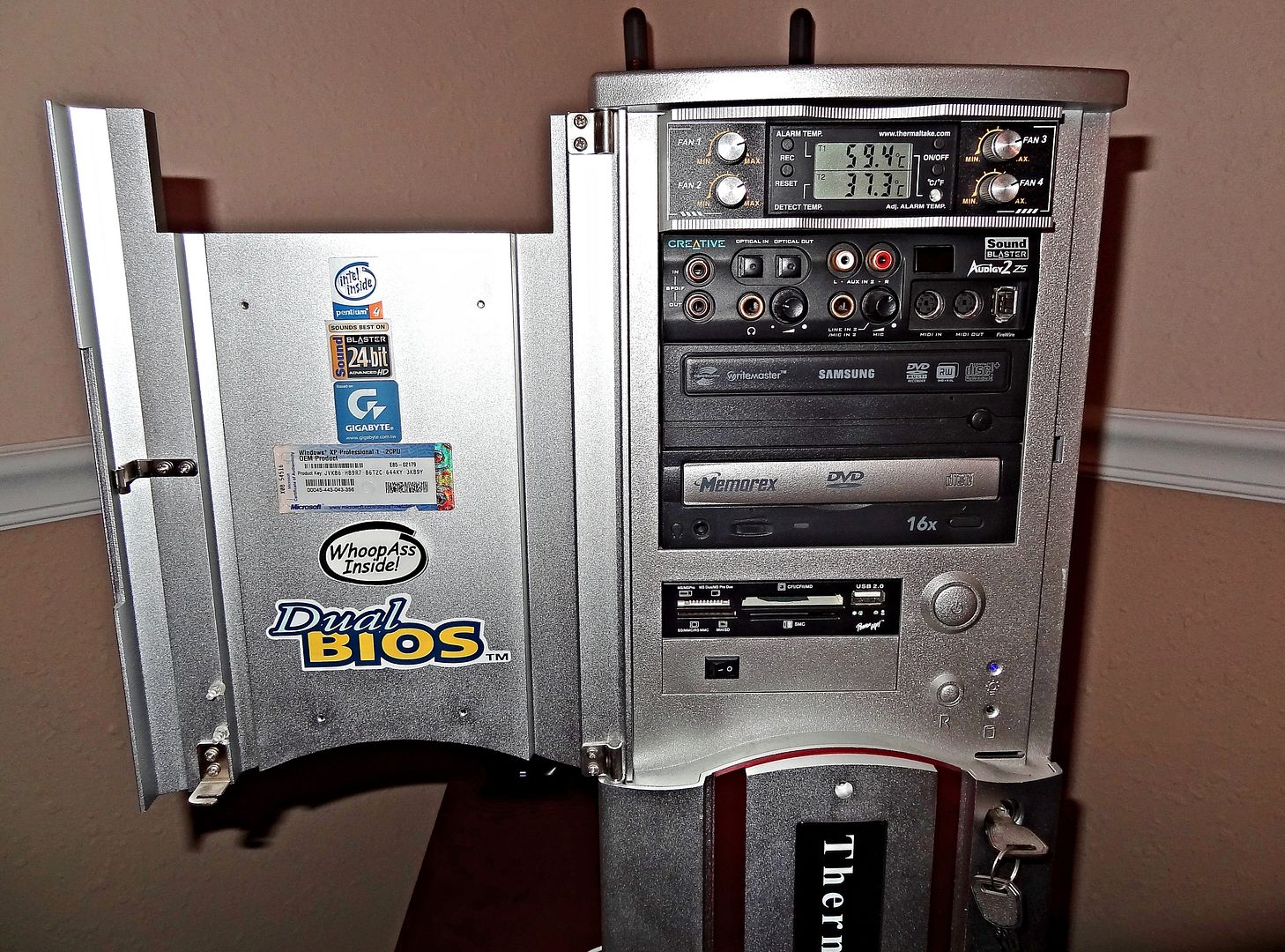

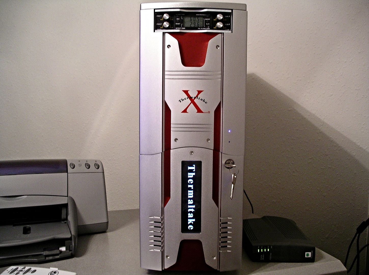

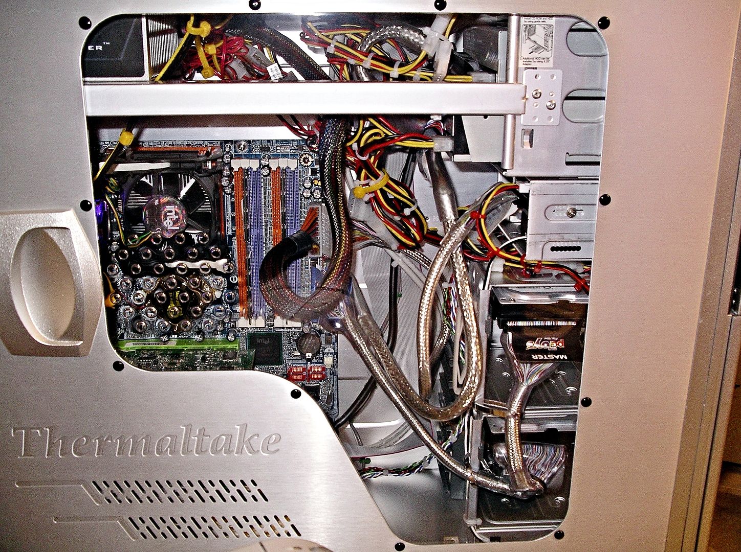

That's going to be a smokin fast machine Bob. The i7 4770 will leave nothing to be desired and I think you'll be most pleased with it's speed. Likewise, the Mobo & Gigabyte 650GTX should exceed your needs and expectations. I'm diggin the Thermaltake Urban S21 too; love the brushed accents, bottom mount PSU and open Mobo tray. Should be conducive to good cable management, something I need to improve on.:)
My last build prior to my current build was with a Thermaltake Xaser III Case & Gigabyte Mobo. I upgraded throughout the years with more RAM, SATA hard drives, improved Graphics, All-In-1 Card Reader, light kit, etc...but it just got to the point where the old P4 CPU & AGP Graphics Card were the unmitigable weak links.
Here's the retired rig.
That's a nice machine too, for a P4. I have that same sound card on my primary machine.
