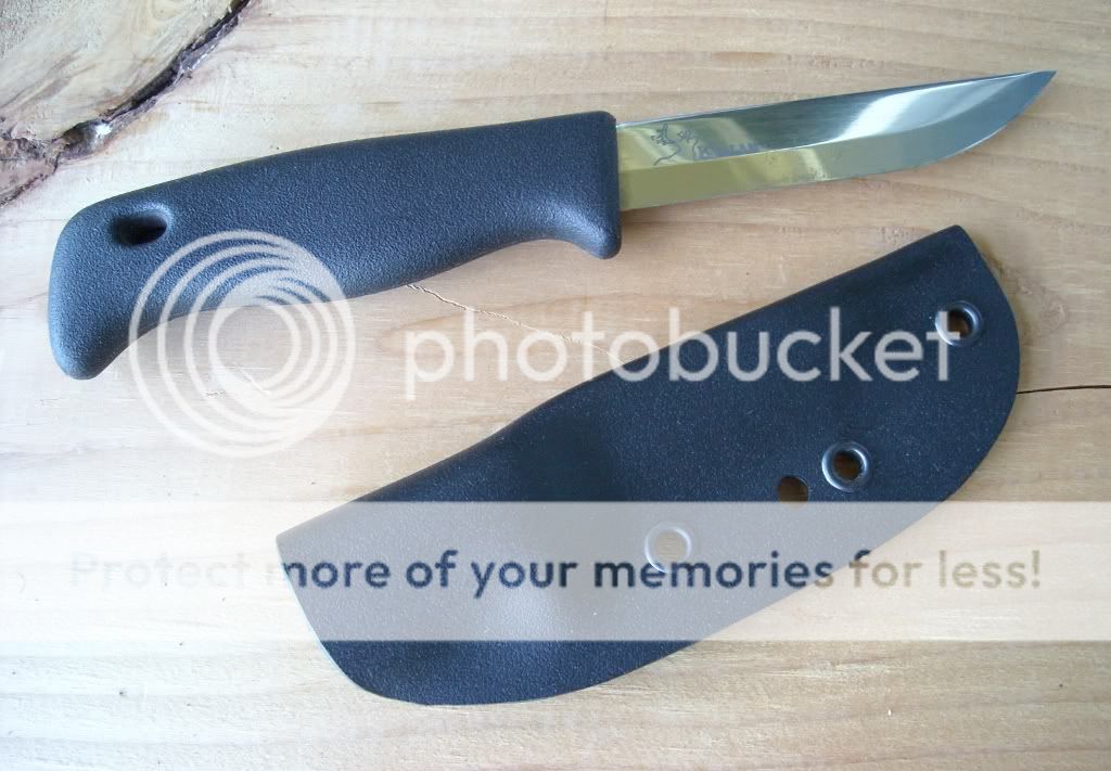

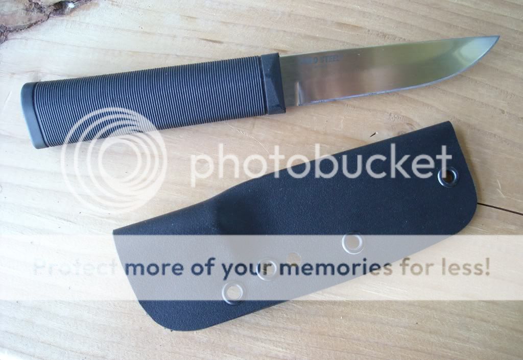

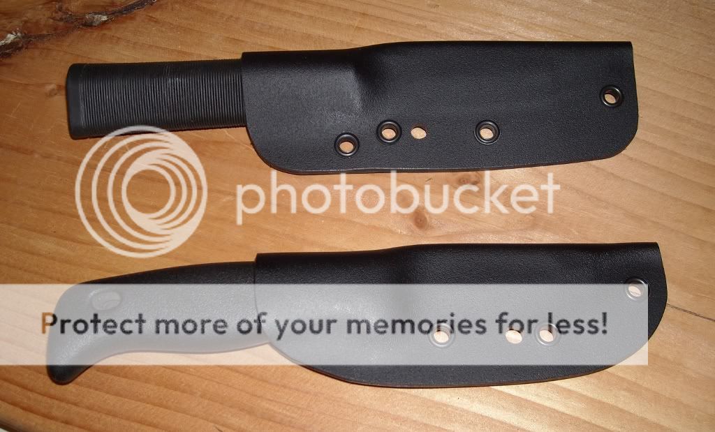

Been making a few Concealex sheaths, and I thought I would show them off...
For a Kellam S Line
For a Cold Steel Finn Bear
Both, in their sheathes

Very nice. I've struggled a bit with molding Kydex. How did you make/mold yours?
I followed Jens Anso's tutorial, and used knee pad foam, like can be found at the garden store. I am not 100% happy with it, but it has worked so far.
KnifeKits.com sells foam specifically for the application, but I am not happy with it, either, in fact, less happy with it than the knee pad foam.

What are you using for press foam, and what sort of press are you using?
Marion
Foam is EVA. Probably the same stuff the knee pads are made from. I buy those puzzle piece floor mats and cut 'em. I do use camping pad foam for folders and thick handled blades, but it gets tossed after one use.
My main press is just two long scrap 2x10s hinged at one end and clamped at the other. Duct tape holds the foam. I have others, but that one sees the most use.
