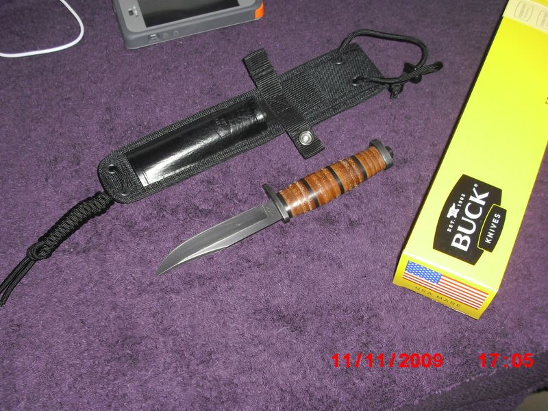

Good day everyone.
I just got my Buck 117 Brahma a few days ago and with all of my Stacked leather handled Knives Buck and others I Sno Seal them. Leather sheathes as well. I like the way it darkens and kind of ages the leather. I have the 119 Brahma as well and they are both really great Knives.
Does anyone condition their Stacked Leather Handles? An what do you use.
