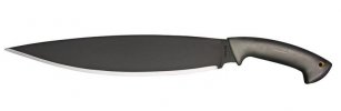

Anyone have one or are these just getting released? If you have one, what's the scoop? Is it fast in hand? Looks like fun.

Funny you should be asking when I just put them on the site. It's like you have ESP or something... :p;) It's a sweet piece of steel! Nice and fast in the hand but with a good heft for chopping. The flat grind is very nicely done, and the belly sits low enough for you to pinch the spine like a chef's knife and use it on a board. The fine point will pierce or drill, and the lower balance and sweet spot placement allow you to reach high tip velocity quickly for taking out vegetation or brambles.
The sheath is different from the snap-flap design you see on a lot of pics online. It's a taco-folded one piece now, like the Boomslang and Rodan/Varan/Kumunga are.

Barongs are interesting in that they're one of the few chopper classes that demonstrate what I call a "mezzo-balance." The sweet spot is further down the blade than on most choppers (its "belly" is very "full" so to speak), and this is what provides the balanced compromise between being able to handle both vegetation and wood. You can tackle thorns with the barong and not scratch up your knuckles because of the fast tip. This is more important (if you have to face brambles frequently) than the extra chopping power afforded by a tip-weighted design. You might have to stand a bit closer when chopping dense wood, but you're not as likely to injure your hand by chopping a log as compared to thorny plants.
hmmmm...I was wondering where the sweet spot is as I studied the photo on your website.
It's essentially the region surrounding the broadest spot on the blade. Widest part marked in red. Effective sweet spot circled in green. :)
