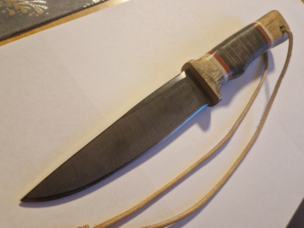

Knife arrived today.
The sheath is impressive, quality leather, good execution and well thought out design.
The handle of the knife is very comfortable to hold and the fit & finish is okaish. There are no corners or something that looks or feel unfinished, but the two wood parts are not perfectly cut at 90°. They made up for it by fitting the middle leather/G10 part seemless in between, but you can definetly see it.
Now the really bad part. The blade is ground uneven. The primary and secondary grinds are waved, it forms a slight recurve in the middle. The secondary grind is all over the place and is completly f'ed up at the tip. It is every bit as bad as your classic 20$ pakistan knife. There is also no sharpness we need to talk about, it doesn't cut paper.
The handle is not attached with any pins, at least non you can see going through from the outside. The brass lanyard sits below the visible tang, so it doesn't act like pin. My conclusion is that the handle is only held on by epoxy, you can see the epoxy at the end and at the beginning where the blade meets the handle.
On a side note, the knife feels super light. If that is good or bad is a question of personal taste, but it doesn't boost my confidence in the handle construction.
I ordered another one to see if I just got a lemon. First one was 115€, second on was 97 (black friday). I still like the look of the knife and could make good use of it in combined use with an axe or hatchet, because I really don't think you can baton this one. If the second one is as bad, I will send 'em both back. I thought of fixing the grind myself, but it is easily two hours of work and I didn't pay 115 to get a knife I habe to finish myself.

*edit* the store where I bought the knives contacted me, because I ordered the knife a second time, and offered to give me the discount from black friday for the first knife, if that's what I wanted. So I agreed and started cleaning up the grinds and then some sharpening. Worked quite well, will take some pictures soon. Used the knife for a little carving, absolutly amazing, gotta admit that.
This is how it looks now:
So, I used it a few days on everything that needed cutting, from meat to fruit to wood to cardboard. It held up just fine, but the 1075 takes a patina from just looking at it and the blade is scratched up all over.
As the knife is very lightweight and the handle is super comfortable, after testing I can recommend the knife. I only did some light chopping to delimb some branches, it works, but the knife is just too light to be effective at these tasks. No battoning till now, but I will make a fire in the next days and test some light battoning too.
