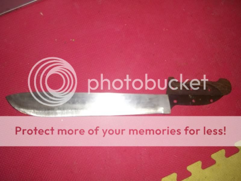

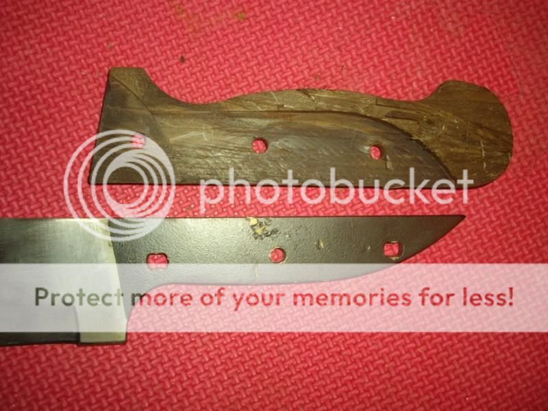

The Linder's stick tang went through about 2/3 or so of the handle. Not all the way to the lanyard hole. It didn't have the lanyard but was triple pinned so seemed strong enough. Just a natural material failure in the wood on the handle. Let me snap that pic real quick of the tang just in case anyone was curious.
The Linder pieces have received pretty poor marks from every source I've seen, so it's not too surprising. :o

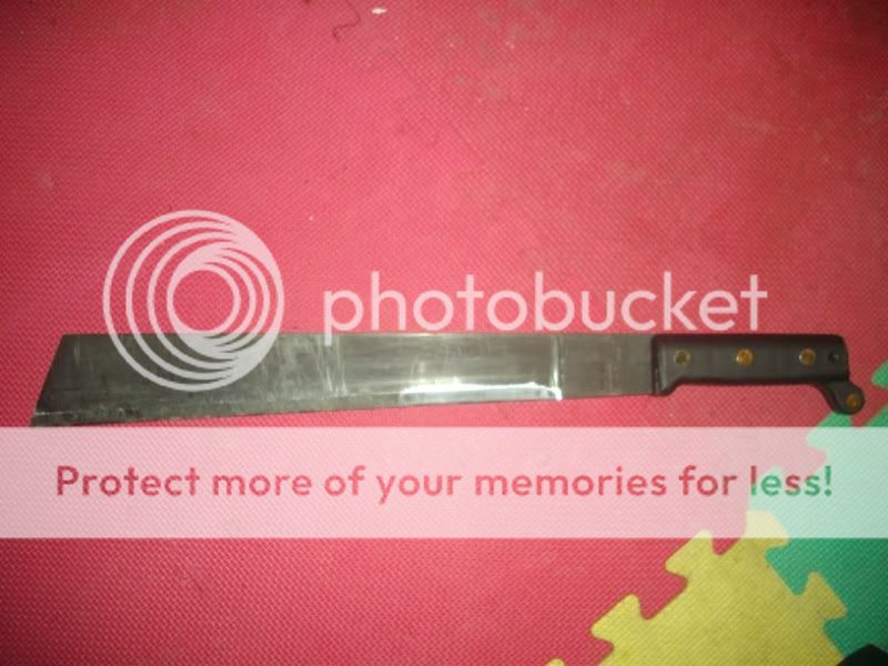

:( Well lesson learned. I'm pretty new to the machete scene. Here are some pics of the Linder in question.
Not sure how to salvage this but I'll toy with it for a bit and do some research.
My ontario (modified to more of a Golok style) has been laughing at everything I've thrown at it so far.

As far as the Linder goes...I'd just chop off the stick tang it has and just cut a new handle out of the base of the blade. It'll shorten it up about 5" but you'll have a full tang piece at least. :thumbup:
Good idea. I have a thread started in the knife makers shop area to get some ideas. Thanks a bunch. :thumbup:
