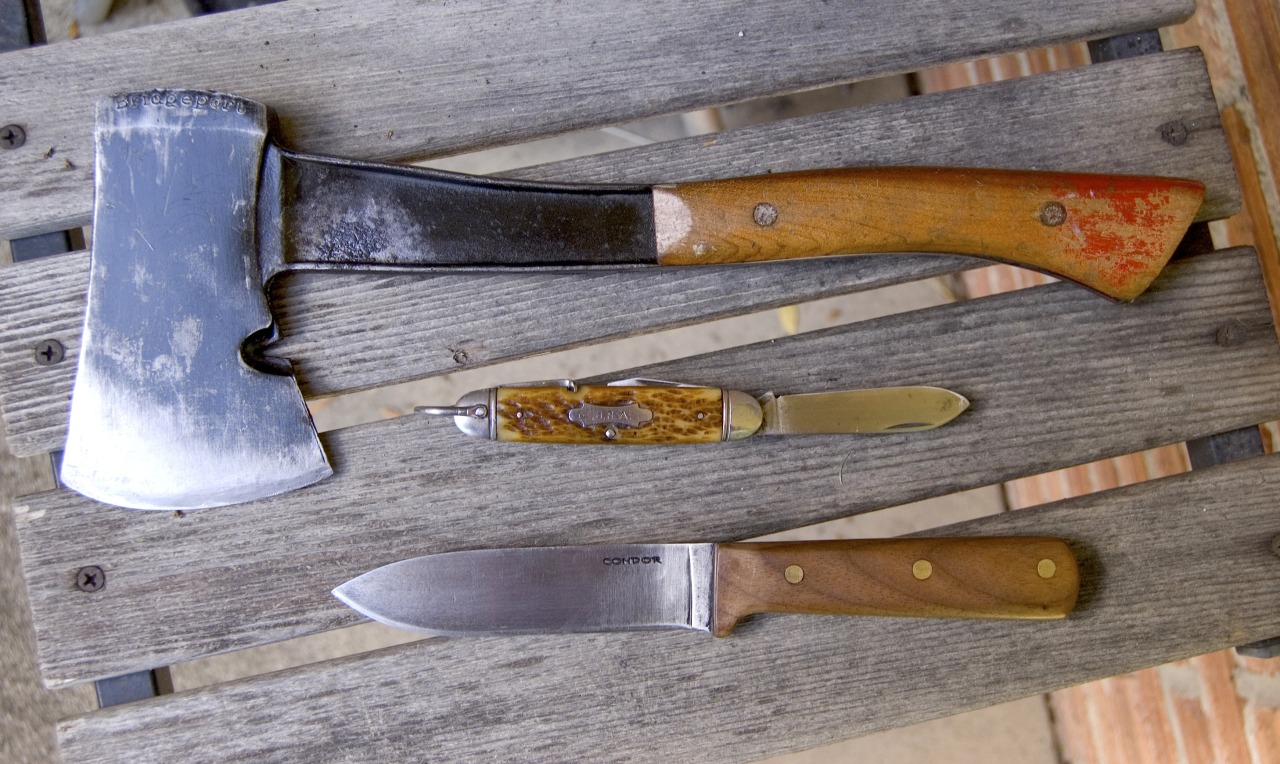

Like all carbon steel blades, it will develop a patina in use. But for fast patinating, get a tall glass jar, fill with ordinary vinegar, nuke it for about 30 secs (until it's almost too hot to touch), then immerse the blade. Pull it out and rinse when the patina reaches the level you want. In hot vinegar, the process goes fast, so be ready.
The Nessmukian Trio: Bridgeport hatchet, Camillus Army Engineer's knife, Kephart
