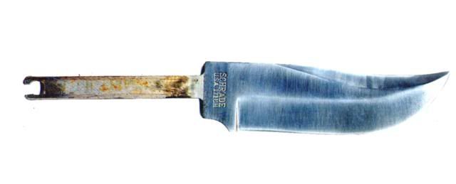

He didn't say if it was a PH1 or a PH2, but I can break any knife you can hand me with the right kind of abuse. I could give you the mathematics involved with determining this particular "failure mode", as it is called in engineering lingo, but basically, the knife he was ABUSING was never intended to cleave through a 2" round of hardwood by bludgeoning the spine with another "baton" of hardwood. With all due respect to Marines, this fellow does not respect the tool's intended use and limitations. The knife was likely 440A stainless. A good blade steel when used as a knife, but not spined, or ground to be either an ax or a wedge for cutting wood across the grain by a driving blow to the spine. This is a civillian hunting knife, mainly designed to be used in butchering game animals. I do take heart in his declaration that he will never buy another Schrade, however. He obviously is unable to tell the difference between a knife and an ax. And I hate to see a good knife destroyed by abuse.

My guess is that it was a 171UH, which has a very large blade but also has a hidden tang. I would think that the PH-1 or 2 with their full tangs would be stronger than the 171UH when used with a baton.
I guess that would depend on the hit. It the blade were hit properly, it would be directly above the point where the blade rested on the bottom wood, and the blow would be perfectly vertical without twist or tilt. If that were the case, the tang strength would not be a factor. It might become a factor if the blow were made at a point unsupported from beneath by the bottom wood (now a fulcrum), and the tang had to absorb the shock and torque instead of the cutting edge and wood.

I don't know if having a full tang or not would have made a difference in the type of breakage described. The blade itself broke, not the handle.

I took apart my 171UH Pro Hunter to illustrate the juncture of the tang and the blade. If the original poster ever returns to the topic, he can identify exactly which knife he was using and where it broke.
