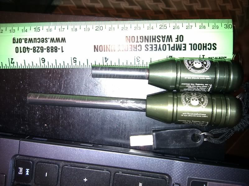

The newer kits are not misch metal. I purchased several misch metal rods (Badger Firesteel - Misch Metal Ferro Rod Blank - 3/8" x 4) from going gear. Make sure to get the 3/8" diameter. I popped out the old rod by placing a metal rod inside the capsule and banging it against the work bench. I then epoxied the new rod into place. :thumbup:

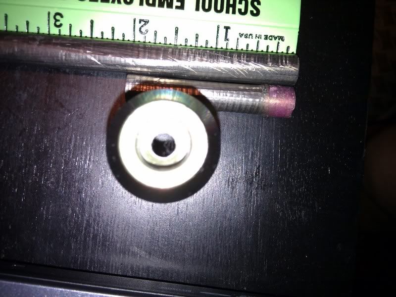

Here are a few pics for you. If I were to do it again, I would get the 3" rod instead of the 4" (when I placed my order, the 3" was out of stock). I also suggest to pick up a few fire strikers so you can save the edge of your knife.
You can see that the stock rod is about 2".
You can see the red area on the stock rod is where they epoxied it.

i have two of the new (non-misch metal rod) fire kits and i just heated up the base with a lighter for a few seconds and the epoxy softened right up enough for me to pull the rod out. i replaced it with a misch metal rod which i epoxied.
edit: i use goinggear.com and firesteel.com strikers on non-misch rods and it throws nice sparks too and hasn't really prevented me from lighting fires. i just like misch metal better for the fun factor since i play with them all the time just to freak out my sheeple friends :D

Both of my kits are screwed in. I’m curious if the hole in the body is the same size so if and when I replace my rods I could just epoxy them back in?
The hole should be close to the same size so you should be able to swap it out.
