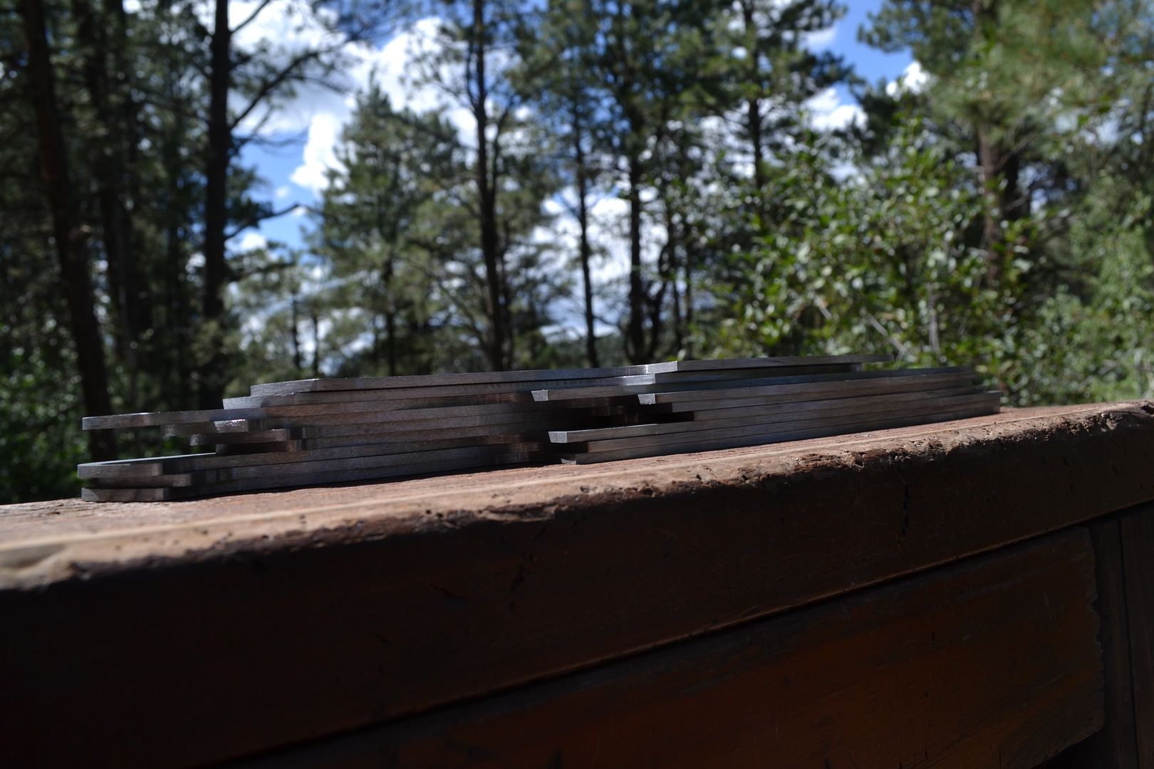

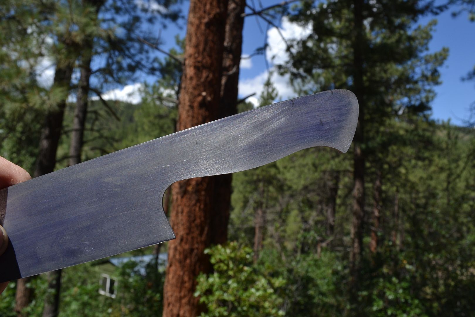

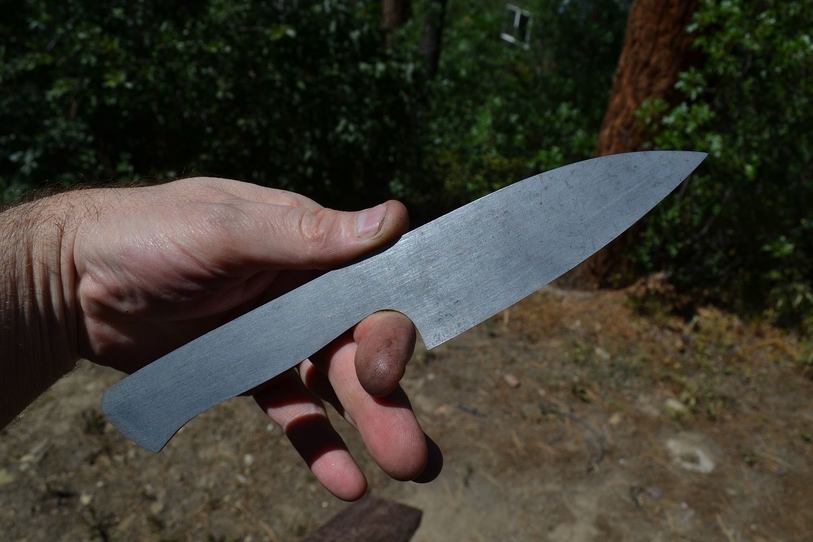

Here's the group, they are all 3/32" 52100 steel.

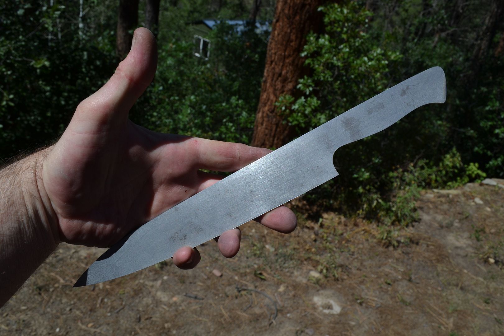

Utility Knife - Ko Deba! This will be chisel ground in the traditional fashion. I'm hand finishing my bevels with stones or sandpaper.

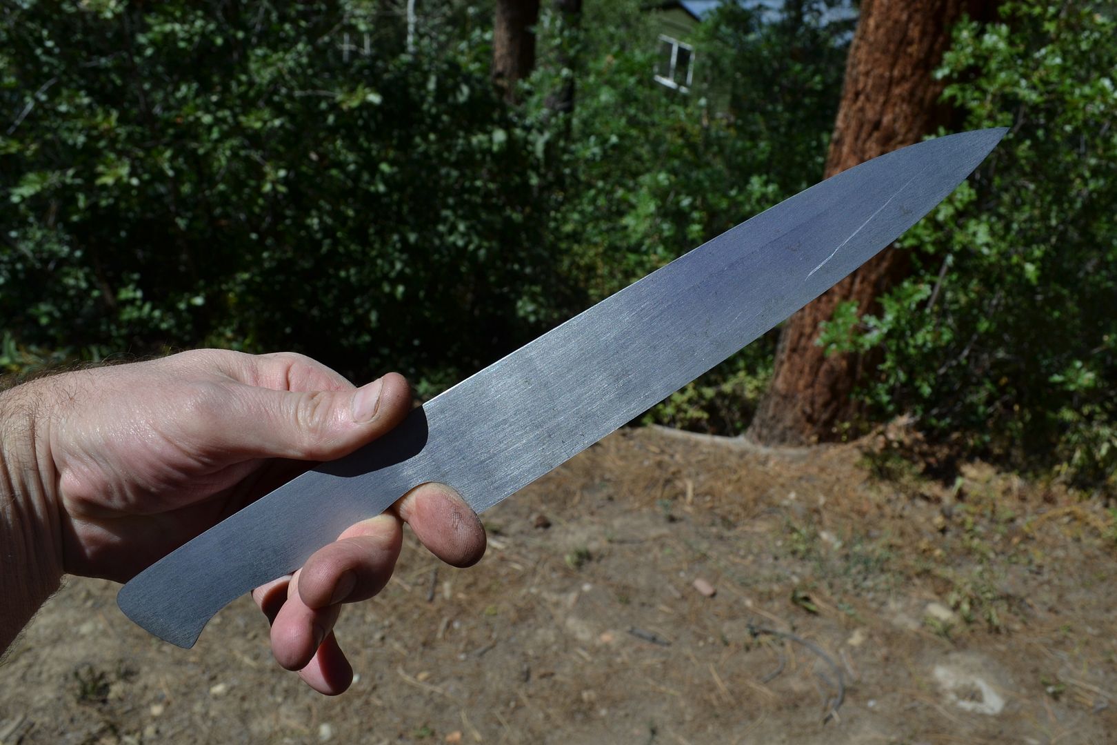

Slicer - Yanagi Ba - This is a tough knife to make, it will have a near zero bevel grind. I'm keeping the back or ura side flat on these for now.

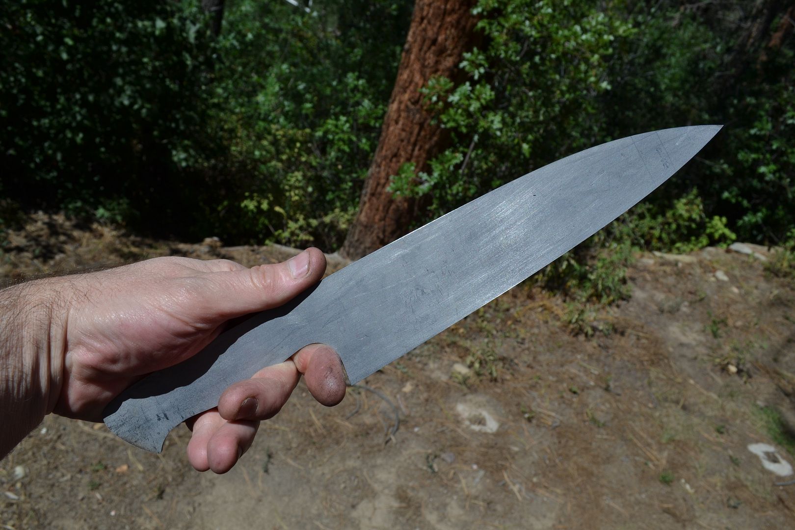

General Utility - Slice, dice or chop with this one... I'll be doing double plungeless as well as chisel grinds on these.

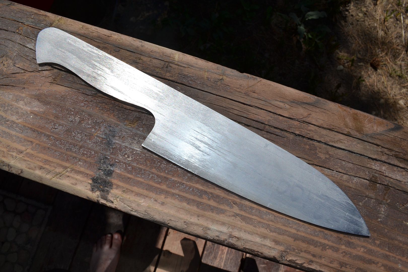

Chef's Knife - Gyuto - 220mm or so... a Gyuto is a Japanese version of a Western Chef's knife, they are a workhorse in the kitchen
Traditional handle shape - this shape really indexes well, the swell in the back helps with control
...more of the slicer! Yanagi Ba means willow blade knife as the shape is similar

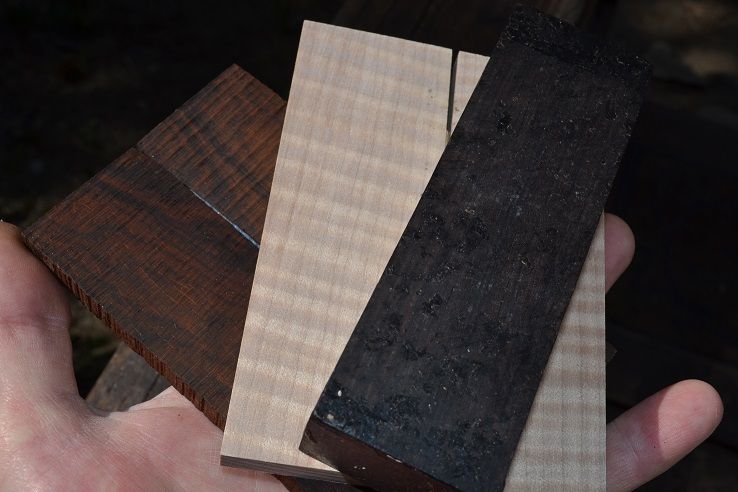

My wood order just came in a day early and I am simply floored! This stuff is literally too nice to use. But I will! :D
Desert Ironwood
left to right - Cocobolo, Curly Maple (stabilized) and African Blackwood! The Blackwood is a favorite, it is the wood clarinets are made from, tough stuff and nearly pure black. The maple just moves under the light, I'm impressed!
