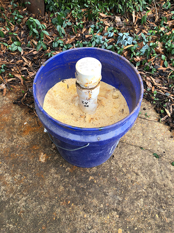

This is what I use. PVC container in a five gallon bucket of sand. Portable, easy to change fluid, and it doesn't drip all over the floor when you pull the knife out. Drips into the sand.
