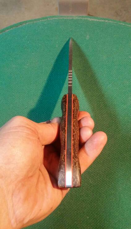

Currently I'm using the 4" wheel on the bottom of my grinder to contour my handles. It's okay but I think a larger wheel would be better.
I'm working on getting a 2x72 grinder with a flat platten, small wheel fixture and a contact wheel. I'm thinking about an 8" for stock removal and contouring. I may get a larger wheel down the road to try hollow grinds. What is your preference? Do you have any video on how you contour handles?

I have a 10" contact wheel and I find it adequate for shaping the swells. I also use either a 2" or 1" wheel to hit the scales at a 45 degree angle followed by scalloped jflex belts to round everything out. There's plenty of videos on youtube I'd imagine.
Spend a little more than what an 8 inch wheel costs and get the ten inch wheel. You will be able to grind nice hollows and do some shaping on your scales. The 8 inch wheel is wonderful except you have to careful with your hollow grinds not to get your blade too thin when moving up your hollow grind..the 10 inch is easier to do a full hollow grind and will be useful for shaping your scales. Larry

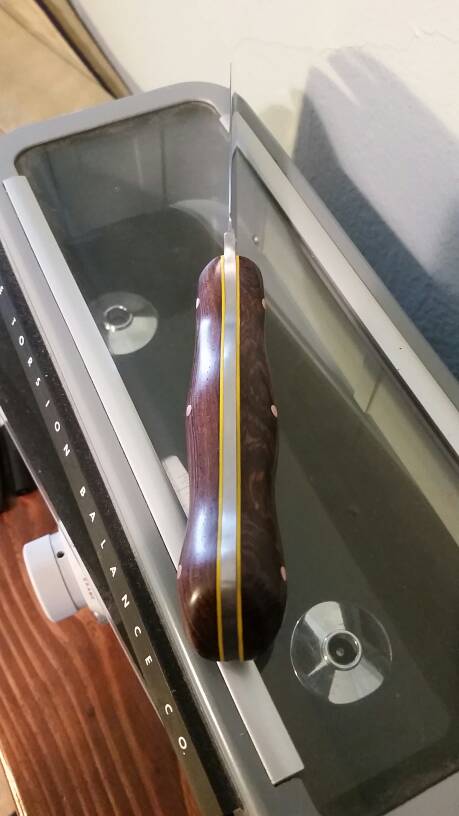

10" is a good all around wheel. 8" is better for the coke bottle, hour glass shape though imo. The 10 makes it a bit more difficult.
IIRC, Jason Knight and Adam Desrosiers did some design work and figured out a wheel size for each part of the handle.
When I visited Jason he used a 5" wheel and the 2" grinder wheel mostly.
I use a 3" and 5" the most. Plus all sizes of small wheels. But it takes me 5 times as long as him to make good comfortable handle swells.

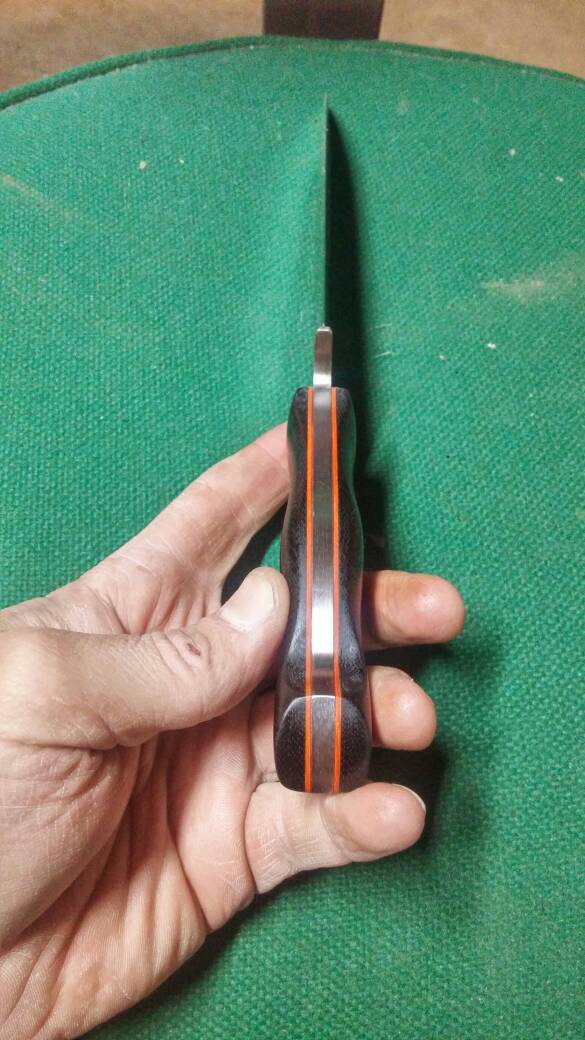

I do my swells with a 5in wheel, marry the spine with a 5in wheel and do the tight curves with the small wheel attachment.
After I do the swells I finish my machine shaping with the yellow scalloped 1in belts from klingspor on the slack platten. Sometimes I take off too much material but its a very fast and clean way to finish shaping. Its far superior to using a rasp or file in terms of speed but again, its very easy to make a mistake.
Getting nice palm filling countours while finding the sweet spot between squareness and roundness is an art and it takes alot of trial and error to get right. And a handle that feels great when you are holding it may not always perform well when you are using it.

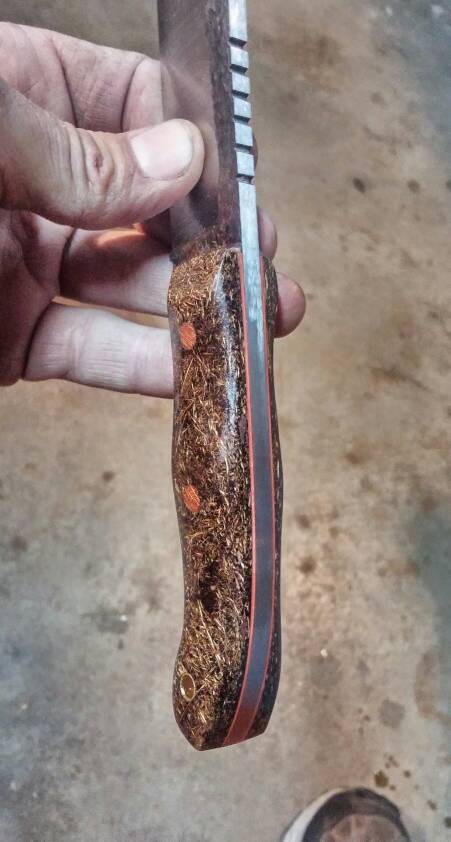

I usually just angle the front of the scales on the disc grinder (I'm not a fan of the bump right in front of the ricasso I guess) and then angle the piece on the workrest to shape the rest. Maybe some slack belt here and there. Hand sanding above 400. I usually do a light buff every other grit to avoid leaving in some hidden scratches. That by itself is a time saver. In the pic below the handle is sanded to like 2000 but the buff revealed some maybe 300 or so grit scratches hiding out in the liner material. If I would have done a look-see buff before that I could have saved myself some time.
