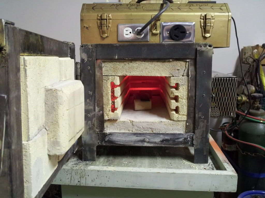

I know that many knifemakers have this type of kiln and cut a hole in the lid to be albe to drop a blade into it from top. But I didn't want to pay for electricity to heat a kiln that was too large for what I need, so I looked into building a kiln.
The big problem here was the price of supplies. Who wants to pay for $6 per soft firebrick just to have it break during shipping?!?!

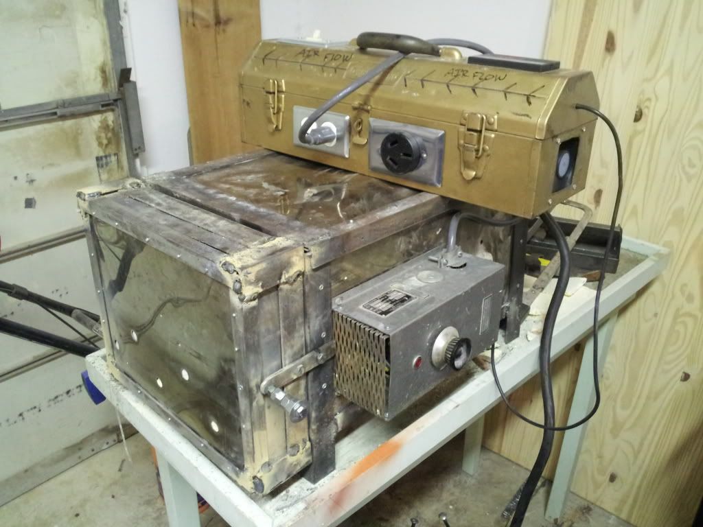

So my solution. I had a knifemaking kiln right in front of me, all I needed to do was make it smaller. I spent about $60 in angle iron and a couple of hinges from Tractor Supply and that is ALL I spent on this kiln.
I used the old kiln's lid and floor for this one as well as the pre grooved firebricks. The old kiln had four 220v heating elements but since I only needed one, I have set the other three aside for future use. I had to cut off about 4' of the prestreched element to fit it into this kiln. After I cut the end off I straightened out with a propane torch, bent about 6" back on itself and twisted it while heating. I was able to use the same element connecters (after buffing them to get off the corrosion), the element spacers, metal heat sinc, infinite heat control and power box.
Since I was only using one heating element, I could use 110 instead of 220v, which is a plus as long as I use the right guage circuit.
To go along with this is a digital PID controller that Stacy helped me build. This is a stand alone box with the ability to hook up 110 or 220 up to 40 amps. It has two SSR's with heat sincs and a computer fan on each end to create air flow across the PID and SSR's so nothing will overheat.
I hooked it up last night and it got to 800C in less than 15 minutes. One thing that concerns me is that during the 800c hold cycle, the temp varies between 790c and 810c. This may or may not be a problem.
I built it to mimic a 14" paragon kiln incase I ever need to buy more elements than I have. Inside dimentions are 4.25" high x 5.5" wide x 14" deep

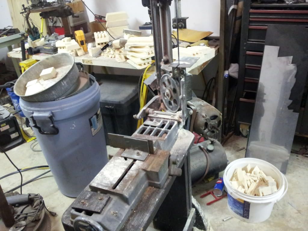

I used my bandsaw to cut most of the bricks very quickly. There is firebrick dust and scraps all over my shop!
