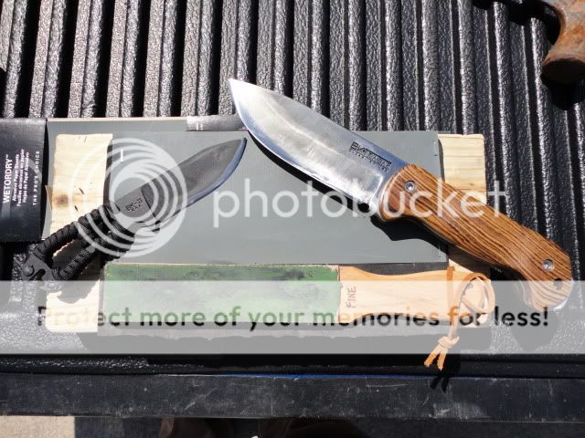

convex is the only way to fly
here is my strop setup

I have the work sharp, convex for dummies. I'm still practicing on cheapy knives before I take it to my 9
