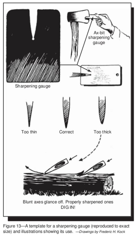

With those flat cheeks you don't need a great deal of 'fan pattern'. I've stated many times that the shape of the cheeks determines the shape of the bevel.
Your axe bevels to the point too quickly. Get a good file and shape it to an axe gauge like this.
Then hone it fine.
A Council Hudson Bay axe is a very good axe for the money. It just needs a little edge work.
If you had ordered your axe from Baryonyx (Special Grade) you could have had it sharpened for just $5. That's a very good deal.
http://www.baryonyxknife.com/cotohubayaxh.html
It's just chunky in the shoulder and needs to be thinned down. Don't worry so much about what the bevel looks like visually in is patterning, and think more about the underlying thickness at different points back from the edge. Try to blend in a smooth arc that is nice and thin immediately behind the edge, transitioning into gently sloped cheeks that give proper support to that edge so it doesn't buckle in use. Get yourself a good quality file and focus chiefly on knocking those bevel shoulders down and blending the whole in. :)
