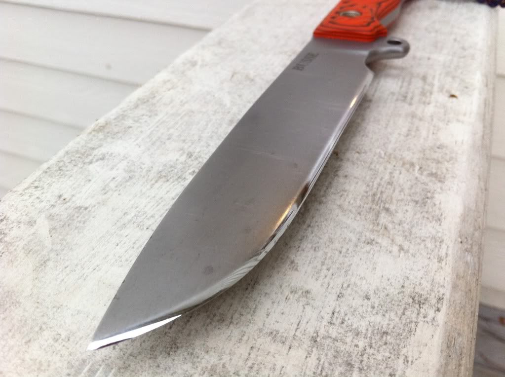

Pics of what Busse considers to be an asymmetric edge (which is not the same as nitpicking a slightly uneven/imperfect V-edge grind that technically can be described as being asymmetric). This is the best all around use factory edge I have ever worked with.
Convex side of Asym B11.
V-edge side of same knife.

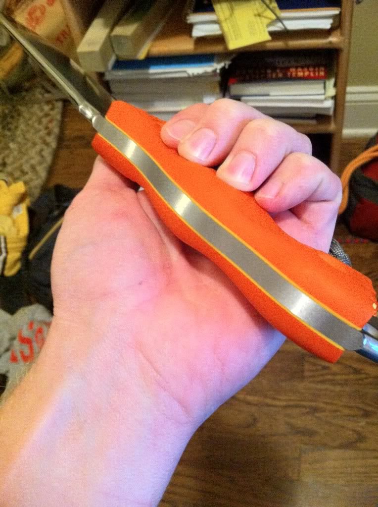

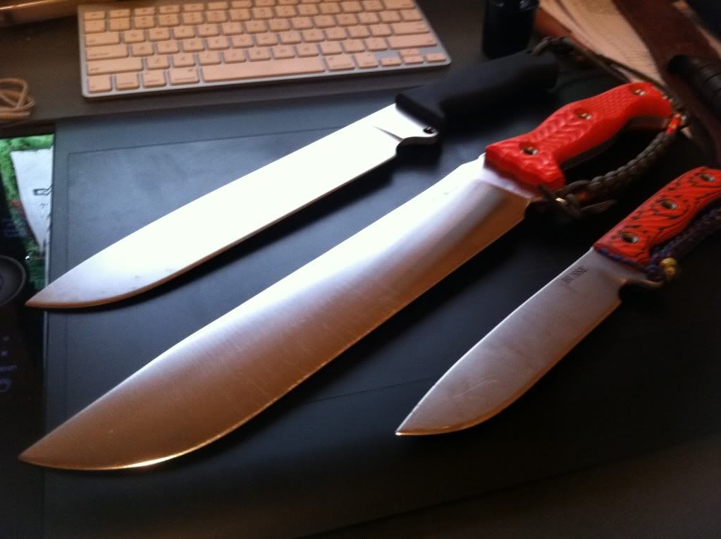

Good pics AZTimT, I would love to see more pics of that stripped CGFBM also...
Ok, here ya go. Some of the others in the pics have come and gone while some have stayed, but that one is still around.
Nice, that looks great! I like the worn in look it has in some of the pics, it shows some character. My CGFBM is actually sitting in a box right now. It's heading back to the factory in the next couple hours for the same treatment.
