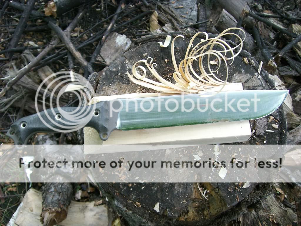

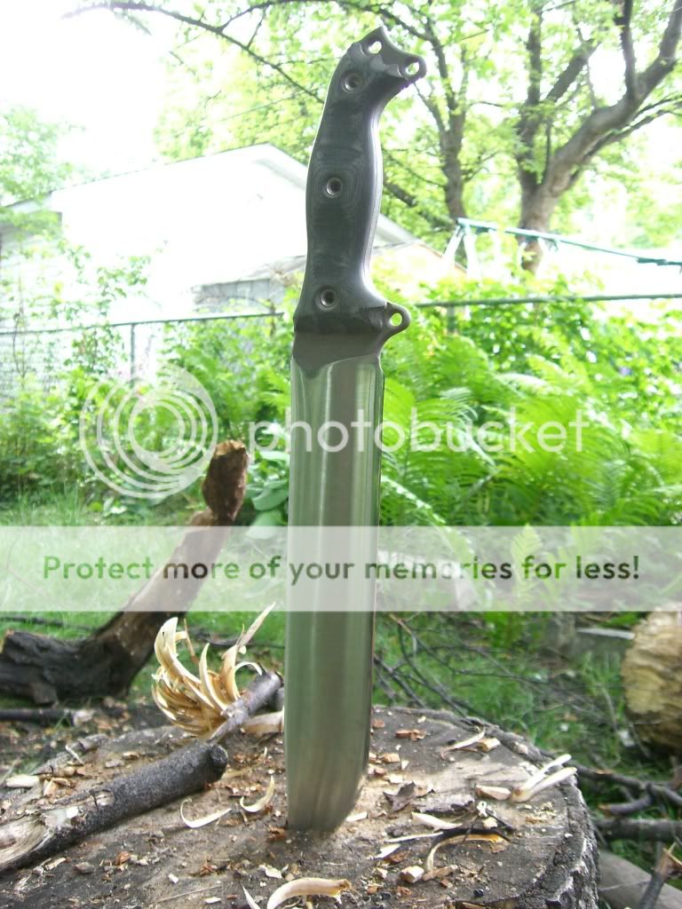

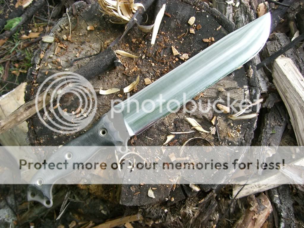

I'm not a fan of coated blades, the only thing I like about them is the price. My CG NMFBM was starting to get a little ugly, the coating was worn, scratched and chipped, and the factory edge left me wanting. LIke a fine statue born out of stone, I knew there was a real beauty hiding under that rough exterior, so I got to work putting the "mistress" back in NMFBM

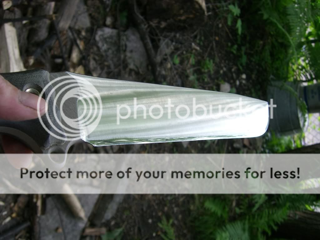

I didn't want to be bothered with removing the handles, more specifically with having to reattach them, so I left everything behind the ricasso as is. Stripped the coating, changed the geometry from a high saber grind with a convexed primary bevel and a "V" edge to a fully convexed profile with a mirror polished zero edge.
Grinding away the dimples and CNC marks was really time consuming work. The finished edge is wicked sharp, whittles hair like no ones business and is still tough as hell. It breezed through branches around 1.5" thick in 1 chop, goes to town on seasoned hardwood without showing any signs of wear on the edge, and it can shave up some kindling all right too. At last, LE performance at CG prices (labor not included lol).

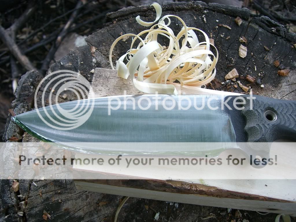

Also gave a similar treatment to my Skinny ASH1, which wasn't seeing much use, again the factory edge just wasn't doing it for me. Wont have any excuse to leave this one on the shelf now!

Just been fooling around a bit, and the ASH1 is officially sharper than my shaver. I dont dare try to maneuver the Battle Mistress anywhere near my face, try shaving with that one and they'll probably have to try and reattach my nose.

Would someone please enlighten me - what exactly is a "zero edge"? Thank you gentlemen!
I believe it means there is no secondary bevel.
