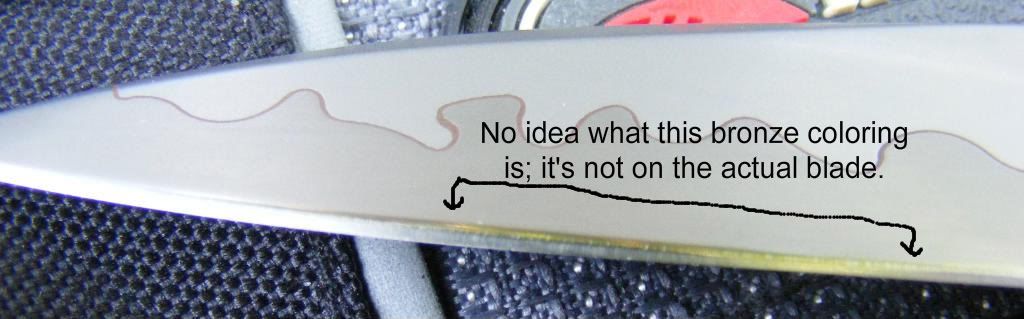

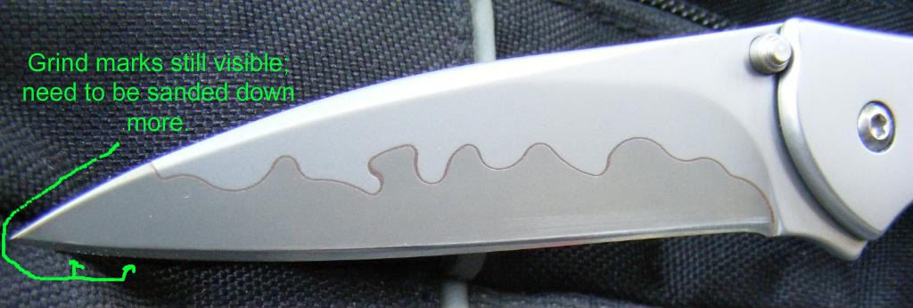

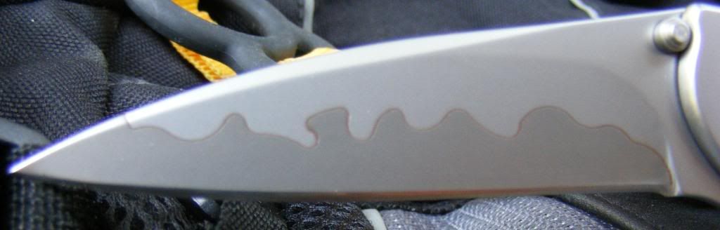

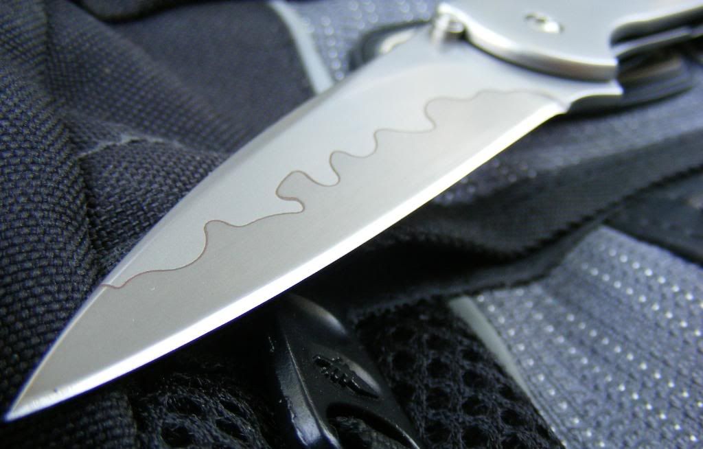

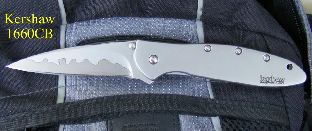

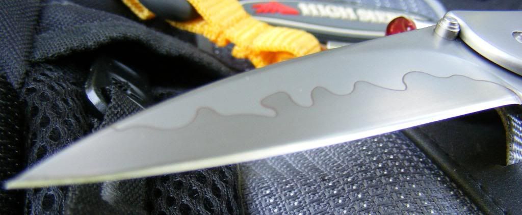

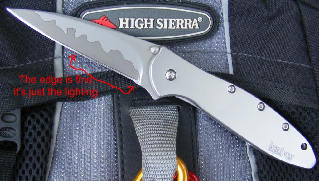

Well, I put a convex edge on my composite Leek. The first few images are the knife as it was completed.
I've got to thank Vivi for the convexing advice :::thumbup:::

Looks good. You should go thinner though :D

I used a medium-grit diamond rod to remove most of the material for convexing. Then a dogbone sharpener for establishing the right edge angle. Sharpening was done on a ceramic rod until it sliced paper. Then it was worked on a sheet of 1000-grit sandpaper until it shaved hair. I stropped on a loaded belt to get rid of any burrs and to put a polish on the edge. Then a pencil eraser to finalise things. The diamond rod, dogbone, and ceramic were lubricated with Tuff Glide (try it). The sandpaper and strop were used dry, and the pencil eraser was used with just a drop of water. Everything was wiped down afterward, and the blade recieved a nice coating on the Tuff Cloth.
Vivi... it's been my EDC since I got it a few days ago. The most it's cut so far has been paper, strings and very thin rope, chicken wings, and some cardboard. It hasn't needed a touch-up, but I strop it every time I use it for something harder to cut than paper.

The convex edge works great if you don't want to take your edges down super thin like I do. Just taking the shoulders off the factory edge bevel can be a great improvement in cutting ability.

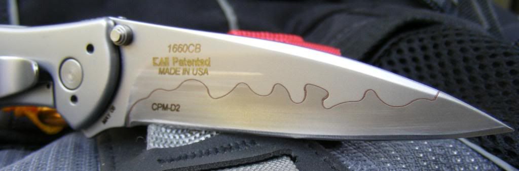

I spent some time today and put a convex edge on my composite leek. The angle is approximately 12 degrees. I used 3M sandpaper (120, 320, 600, 800, 1000, 1500, 2000) then 100 strokes per side on a strop loaded up with Tormek honing compound. It is insanely sharp. This is my first knife with CPM-D2. I'm not a fan of the stainless handle so I stuck a piece of grip tape on non-clip side.
