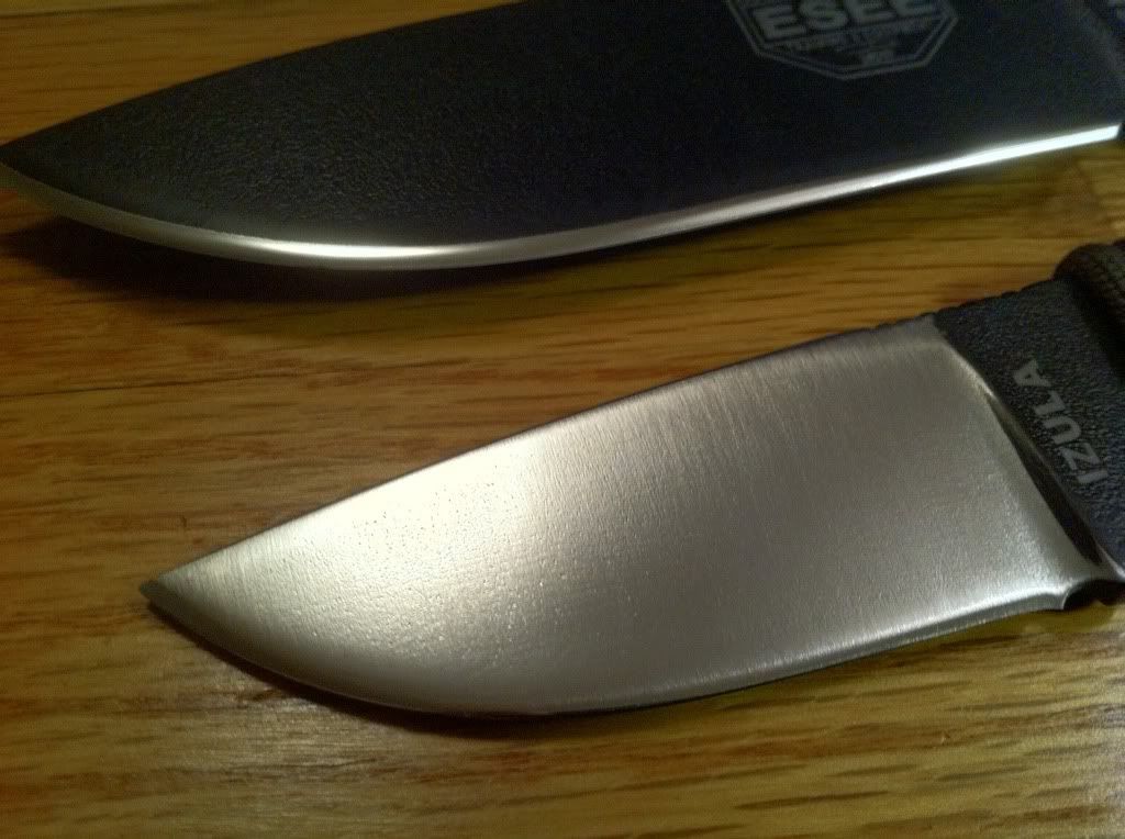

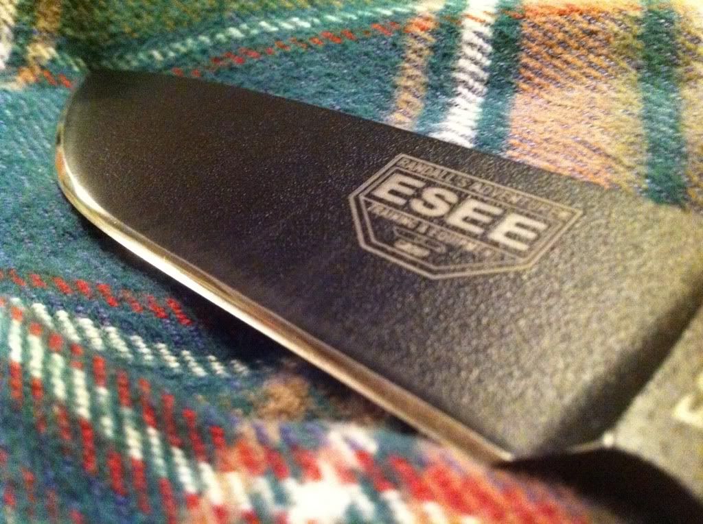

Convexed my ESEE 4
Nov 14, 2010
267
Just thought I'd share. :-)
200 grit
400 grit
800 grit
Mothers polish on cardboard.
Thanks! She slices beautifully, so much smoother than before. I'm sold on convex edges.
Here is another angle with my izzy...

I'm sold on the convex grind as well. Here is a bad picture of my 6. The problem with the convex is when people make the grind too thin. Kind of defeats the purpose behind the convex.
Your 4 looks real good.

Edge thinness is all relative to the job. A very thin edge is amazing at slicing soft materials, but not meant for hard use.
I have some Barkies with the thin convex, Mountain Man, that cut through paper almost in silence. I would not baton that knife, or cut bone. It's edge is a trade off, to me it's a big scalpel.
I have not convexed my ESEE 4, yet. As I sharpen it, I will knock off the shoulder, and that's about it. I want a thicker edge to a knife like this, so batoning and cutting bone is possible.
Nice job Pea-Ta. I've considered this myself as I'm big fan of convex grinds/edges. Not sure if I ever will though. Seems to me you would have to blunt the edge quite a bit, then blend in a convex edge in order to maintain an edge angle that isn't too thin.
Looks damn nice man. Your making me want to convex my 4 and Izzy also. :p
I know this doesn't sound scientific but before I convexed it I reprofiled her to 30 degree shoulders and a 40 degree edge. Then hit the sandpaper and mousepad. The geometry "should" kinda be in the same ballpark.... Right :-)
