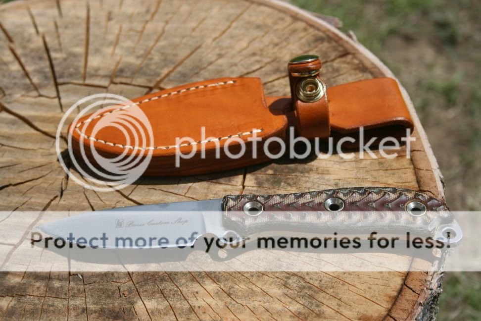

Got a pic of one of those, RT?
I can still see a hint of the sabre-grind. Did you actually flatten the entire blade, or is it still sabre-ground with just a convex edge?
