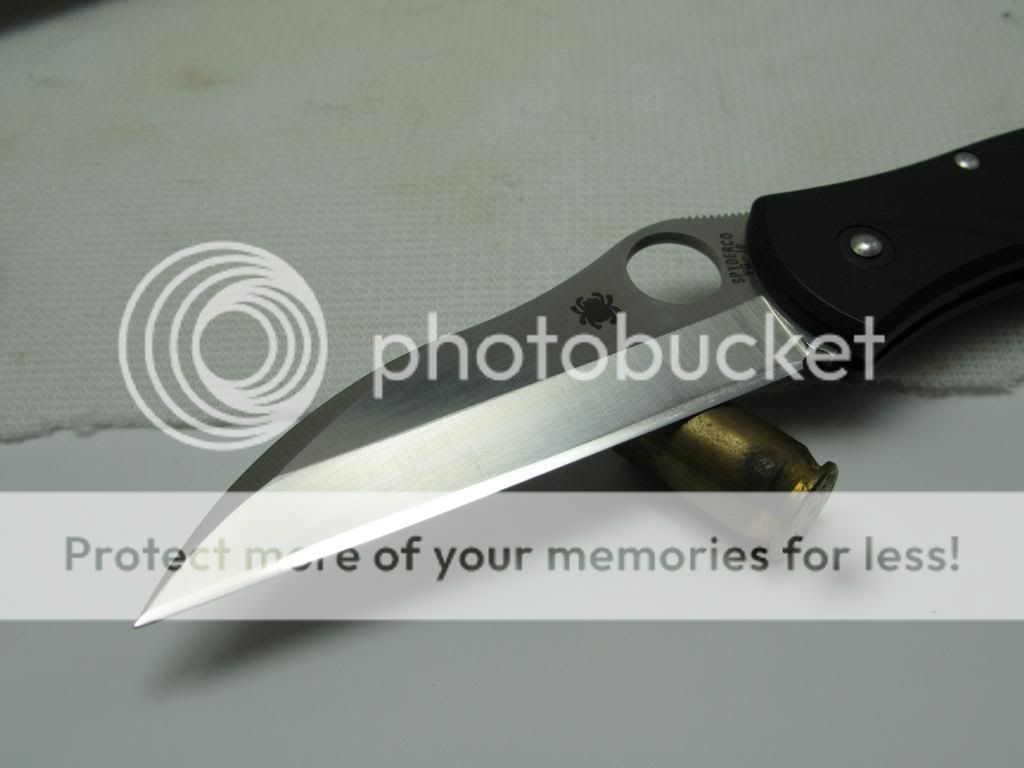

Some edge pics, just for fun:
Paper wheel edge:
Edge Pro:
Mild Convex (needed to be polished still):
Convexed & polished:
Covexed S90V Millie
