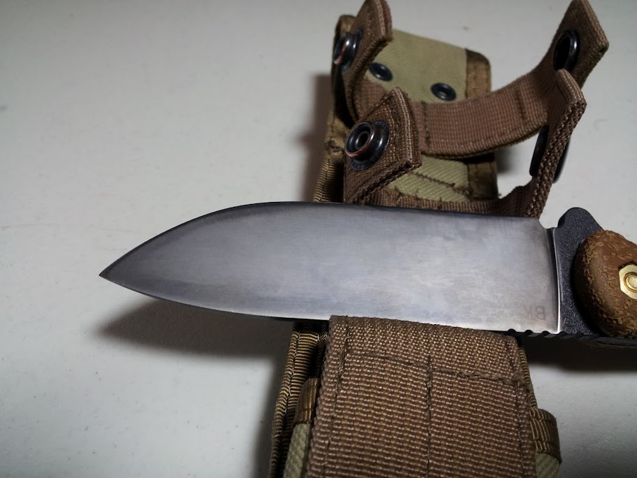

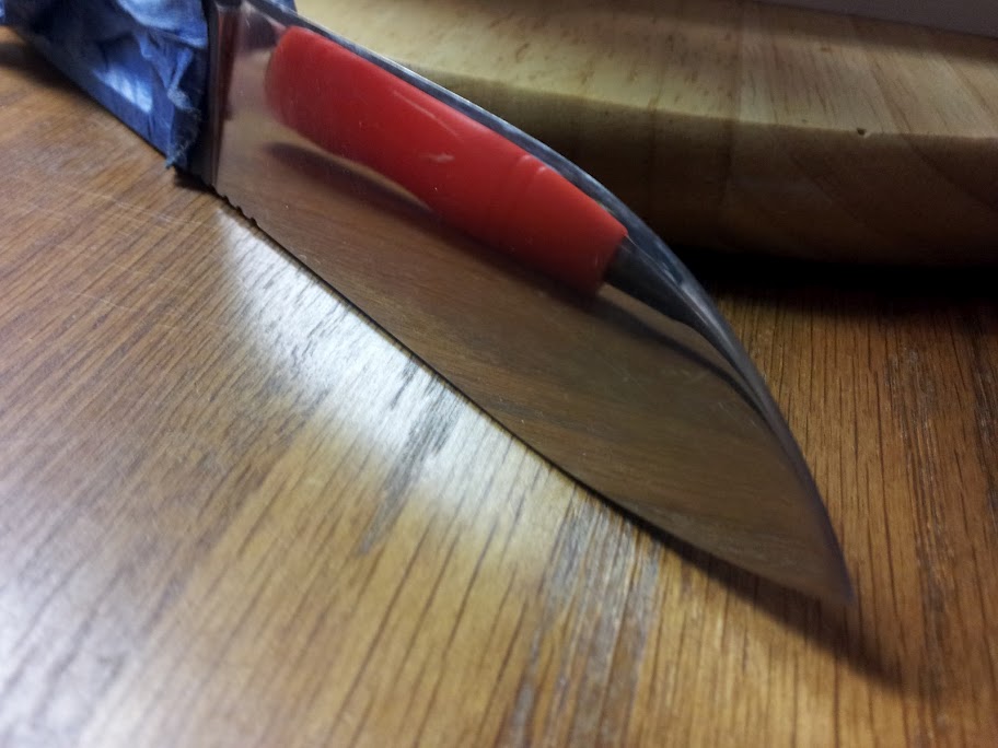

Next a few shots of the knife after I finished sanding it (went up to 2000 grit)

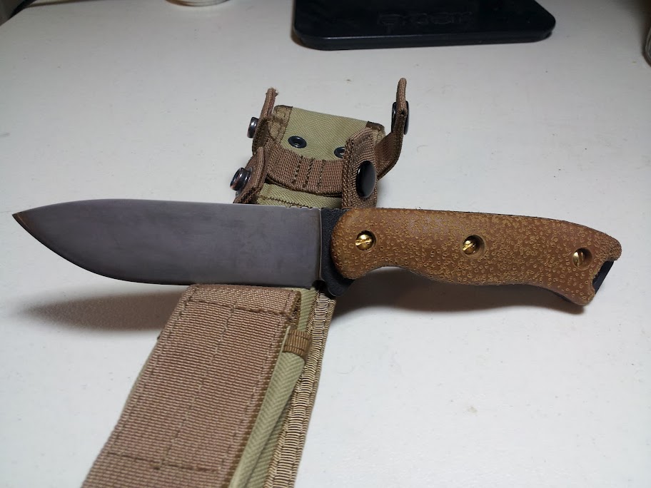

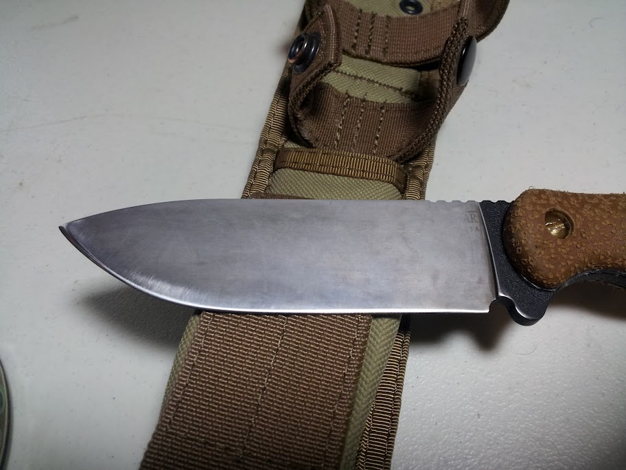

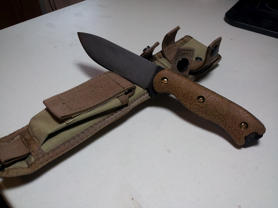

And finally, after I forced a patina, sharpened the now convex edge, and made the handle more "grippy"!
Found the 5/8, 8/32 brass screws at lowes. I like the flathead > hex.
You can't see from the shots but I have some opaque liners. All in all I think everything came out great! Thanks again for all the help. I owe you guys a beer. :very_drunk:
