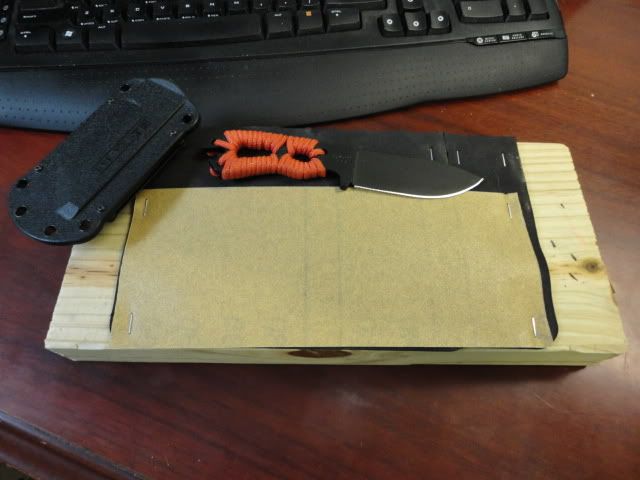

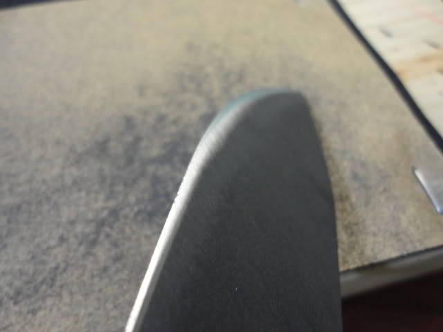

half hour of going at it with 150 grit
should be ready by the end of the day (time pending with honey do's) for the leather strop...

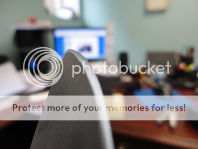

If I'm thinking of the right thing. I did my 14 on my stones. It took no time at all, and it stays sharp for a long time (even after making a fork).
I have a question though; why do you say to strop from tip to hilt? I've been doing it the other way.
Anyway here is a pic of my edge.
I used to do it heel to tip as well because that's how I learned it. The guru of the convex edge told me try it the way he does it and I did. It's much easier, for me anyway, to maintain the proper angle (I think because it's easier to drop the angle from tip to heel than lift it heel to tip consistantly). The main thing is what works for you and if you're getting good results then stick with it. However, if I were going to teach my grandson how to do it, it would be tip to heel. It's easier to learn IMHO. I can do it either way but that way gives me the best results. Your edge looks pretty good there.
