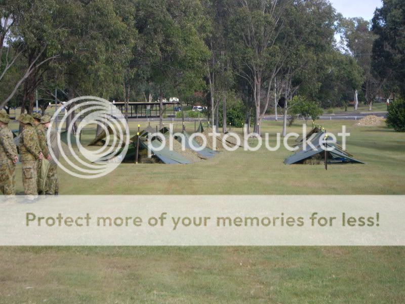

Male cadet sleeping arrangements.
A Hootchie is a glorified tarp. Two join together by press studs ( as seen here) with loops and eyelets down the sides.

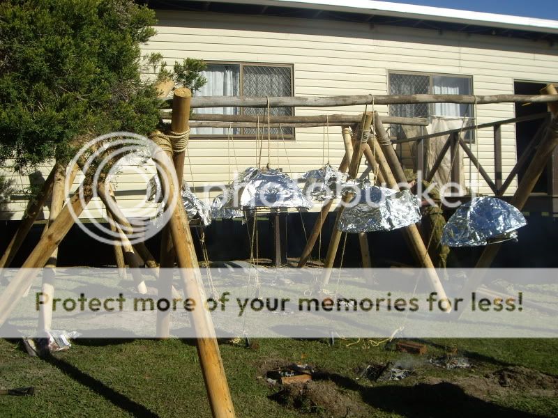

Bell ovens, a grill supported by four fencing wire struts to the top covered in alfoil like a pyramid. One panel is connected only at the top so it can be swung out of the way the heat is regulated by the size of the fire and/or the hight above the fire. There were cakes, pavlovas and roast beef cooked in these. This pic they are up waiting for the fires to burn down.

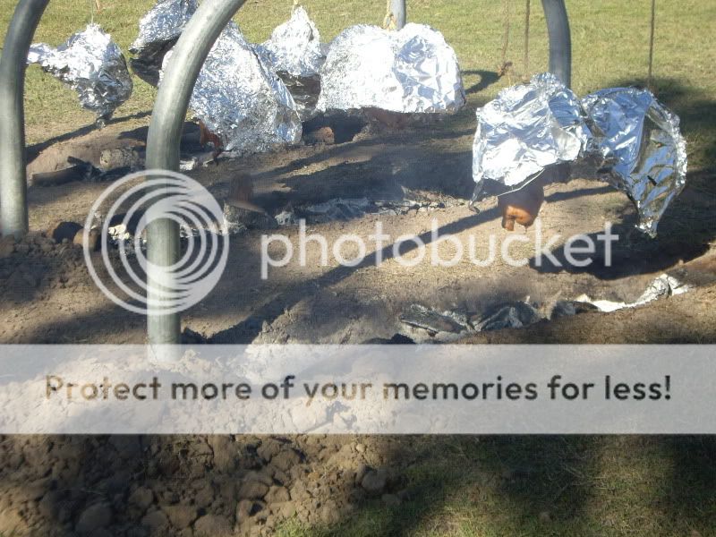

Same concept but just a wire hook through the chook, trussed so it didn’t fall apart and open on the bottom.

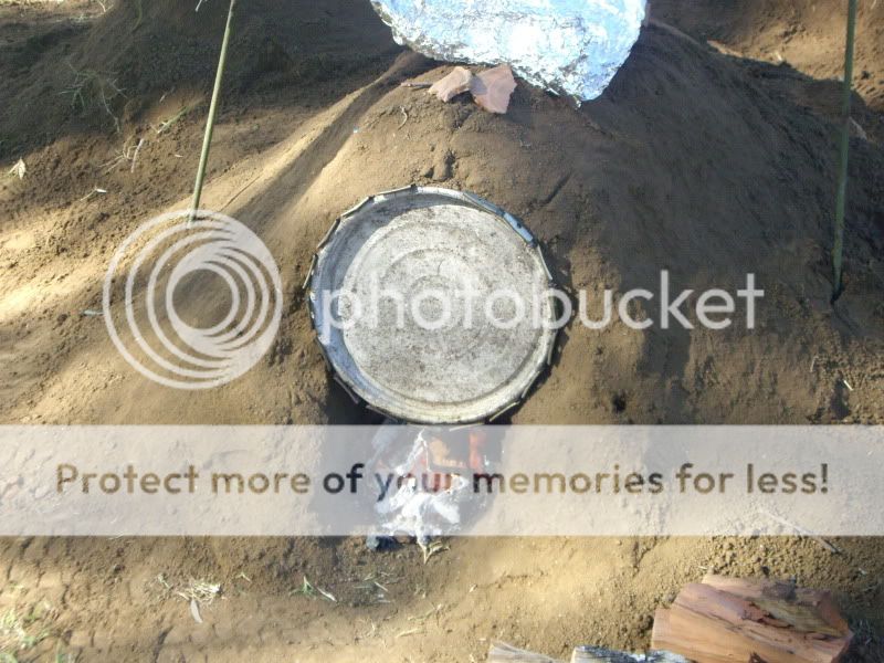

Mud ovens A 20lt drum with a fire trench under neath and chimney at the back, a wire rack in side to keep the item from contacting the base and burning.

The mud ovens were made with spoil so dig a hole for something else they must be above ground. and it takes a fair bit of dirt, sand is harder and needs to be wet to hold in place.
You can make the fire trench buy puting an object in the ground under the tin and then remove it carefully or by filling it full of twigs/kindling and burning it out. Same with the chimney, chim needs to be at least 2x4 inches ( you have to get a draught) hole underneath needs to be 6x8inches square you need to be able to feed the fire. The dirt will need a good pack down with the back of the shovel before you try to remove the moulds sticks or whatever your using.
The drum is a empty 20lt steel drum.like bulk paint comes in. clean and obviously not one that stored anything hazardous.
The tray for the bottom should be long enough to reach the back and be an inch on two short of the front of the drum. it should be wide enough to sit a couple inches off the bottom. For fridge racks try any store that sells new fridges and removes the old ones. don't forget to keep the lid of the drum it has to sit/balance on the edge of the drum it doesn't need to be a tight seal.

Thanks Carl. That helps.
I have a dream to do an extended remote camp once a year, and this the kind of thing that would fit that kind of camp.
