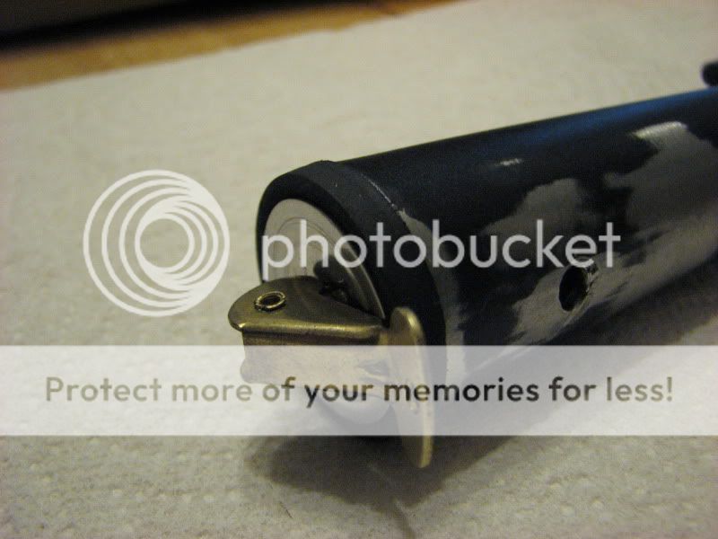

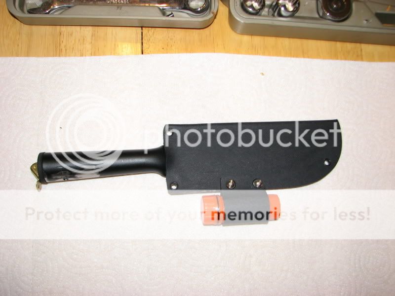

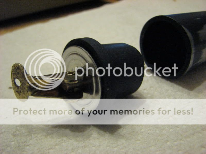

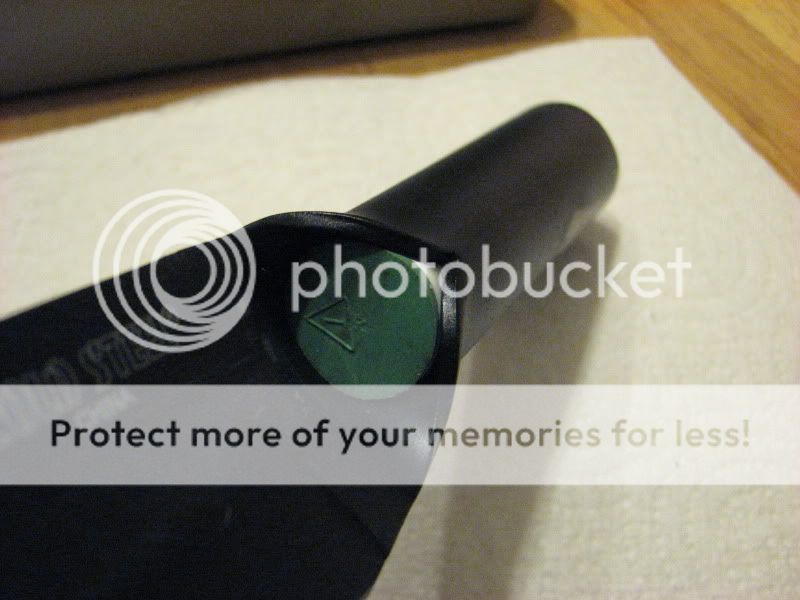

While trying to figure out how to add a cap to the butt of this thing I tried a couple of things. First I fashioned a kydex cap, but I think it would be easy to accidentally knock off. Then I decided I might try to epoxy a threaded PVC coupling in there and use a screw cap. Well the piece that would fit offered only a very small hole, and took away the ability to use it as a spear point. Then I noticed some boat plugs I had sitting on a shelf. Nah, that would be too easy. But they fit perfectly! You can pick em up anywhere marine supplies are sold, for a few bucks. They have several styles, some screw, some have a little lever lock, like this one. All of them adjust for a very tight seal. Waterproof in fact, which is always good when dealing with keeping water out of a boat. Now I'm going to fashion a push in plug for the other end, something that could be pushed out. That'll be easy, due to the taper of the handle. Thought some of you guys wanting to add kits to the handle might like this.
