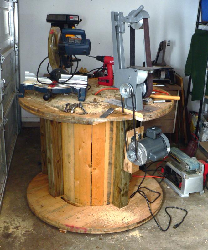

Since I mostly make Bowies, I use a 4X36 most of the time, and am about to get a 6X48. So my Cootes is set up for smaller blades and finishing - it's a 2X48". If you mainly use yer Cootes for grinding a 72" is probably best.
Here's my set up with a 1HP GE Motor -

I have mine set up with step pullies, also bought from norm. And I welded up a hinged motor mount out of some angle iron so that all I have to do to change speeds is lift the motor up and move the belt over. No tensioners to adjust, no tools or anything to worry about.
I went with a 1-1/2 HP Dayton,1725 rpm, high torque, capacitor start, farm duty motor. Totally enclosed and fan cooled of course. This thing is a beast, you can't bog it down, and it was less than $150 new from graingers.
