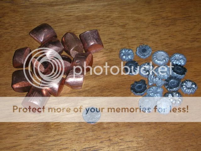

I was cleaning out a cabinet in my garage today and found a container of copper and nickel ingots used for plating that I had grabbed from an old job some years ago. I don't have a set up for plating anymore and don't think I will ever need this much again.
But now that I have found this new craft called knife making I am wondering what I could do with them? I don't have a heat source beyond a MAPP torch so I can't really forge them into some killer damascus steel, but do any of you guys have some fun or different ideas of what to do with this stuff?
Here is what I have left...
-xander
If you can make a small crucible out of a refractory brick you can melt the copper with the torch... The nickel might be a little difficult but still possible. Cast some guards or pommels.

the Ni looks just like the little bits that come from the smelter... or at least that is what i was told when someone passed me some of those bits...
i forge welded them to some iron... in a stack... it worked out ok... at least thats what i can remember from 10 years ago... hah
i'd do what the other say... with the copper... make a bronze

Stacy, I should note that these ingots are of known source and were purchased from a reliable plating supplier some years ago, I simply found them hiding amongst my things in my garage. Interesting note, the copper is actually from high tension power transmission lines. 1" diameter copper wire that they slice into chunks.
I understand the dangers and precautions of casting metals, but I also know what I don't know. I don't want to get into melting metals or casting, etc. I think I may just keep one or two of the copper ingots for small plating jobs or maybe anneal one or two and hammer them flat for some bolsters. If I remember correctly to anneal copper you heat to ~1450*F and immediately quench in water. Sound about right?

Xander, check your messages, CGWbear, for the sake of everyone who cares about you don't try melting unknown brass with a torch, that white smoke will be AT LEAST zinc fumes which are deadly, and who knows what other toxic crap might be in the brass. I don't mess with open melting of brass, and when I get my casting foundry built this summer so I can do 5 pound plus melts I may still stick to bronzes. Brass is just bad news cheap crap metal, unless you are getting a brass meant specifically for casting with it is not worth melting, most brasses these days are leaded to make them freemachining, which is great on the lathe, not so good in a furnace.
Xander, you are right about annealing copper. The thing to remember about working copper is anneal frequently and then some
