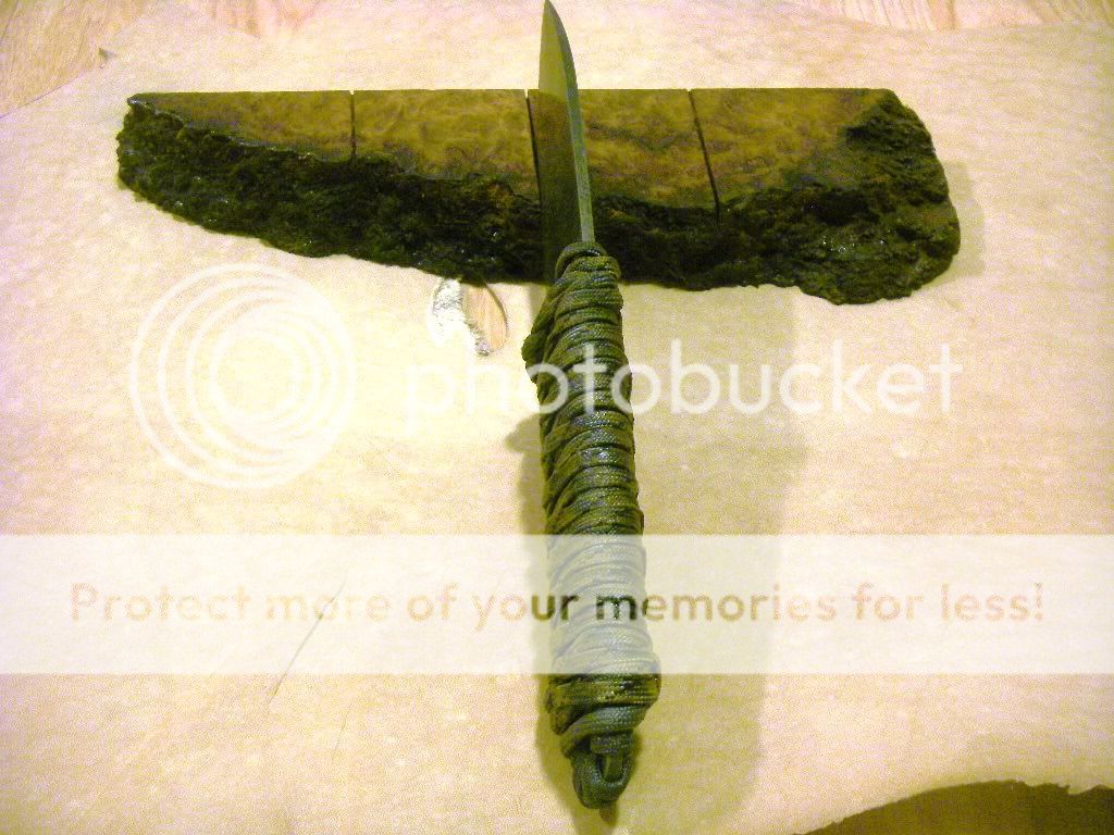

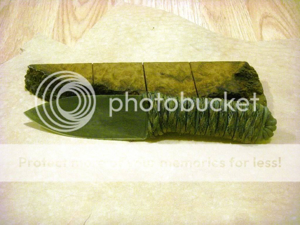

I'd been wanting to make a knife with a cord wrapped handle for a while and then I saw Storm Crow's very nice SERE blade :http://www.bladeforums.com/forums/showthread.php/913040-Primal-Tactical-SERE-knife and it pushed me to do one. This one is 1/8" O-1, 9 1/4" OAL, 4 1/2" blade. Stock removal, flat grind, secondary bevel. The Cord wrap is gutted Digicam paracord over 2 layers of grey paracord to add some thickness to the handle. A not-so-great 4L-5B two strand Turk's head knot forms the pommel. All paracord has been saturated with ZAP thin CA.

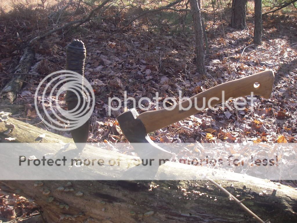

I did get a little woods time in on Saturday and got to try this knife out a little:
A little fire prep (too windy to actually make a fire for no reason, but its good to practice.)
Next to a Wetterlings SAW13.
Thanks for the comments, guys. The CA held up fine and did not appear to be brittle. I had to trim one loose end on the Turk's head knot but I think that was my fault. I should have tied the Turks Head with the loose ends handle side and not blade side. Overall, I'm happy with it and will probably make more.
