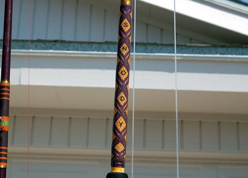

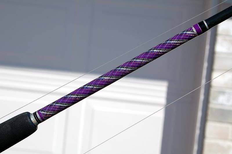

I also build high performance custom fishing rods,
Here are few images

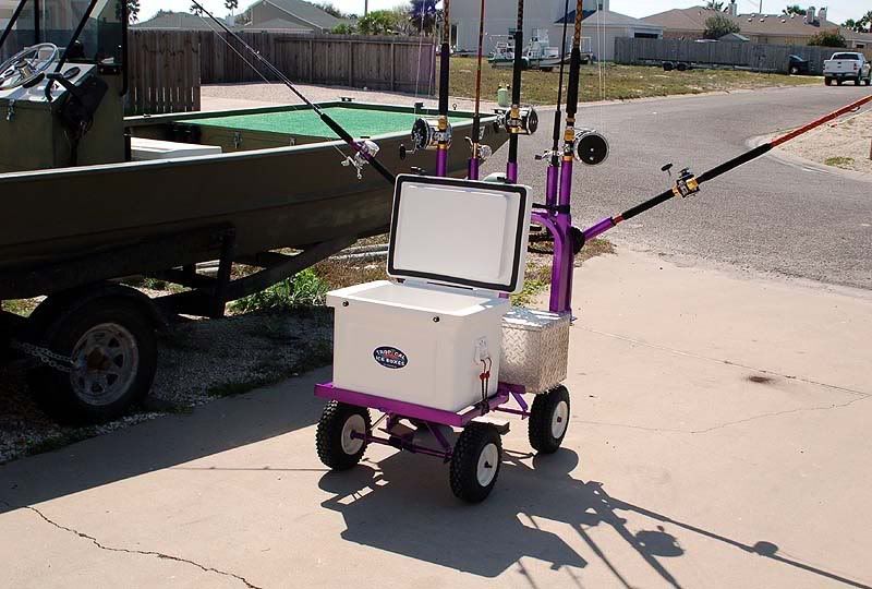

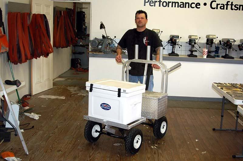

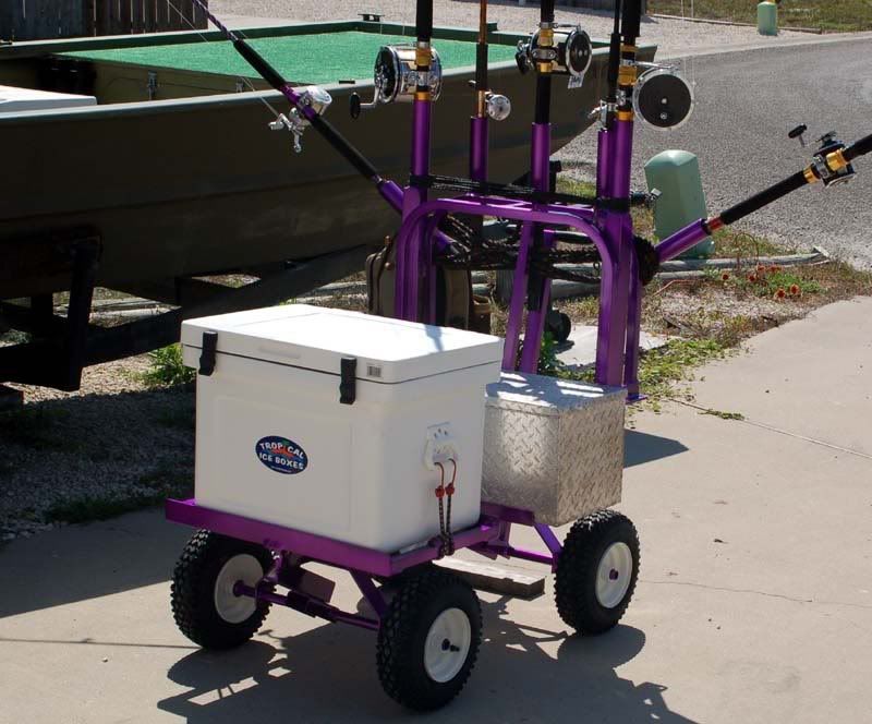

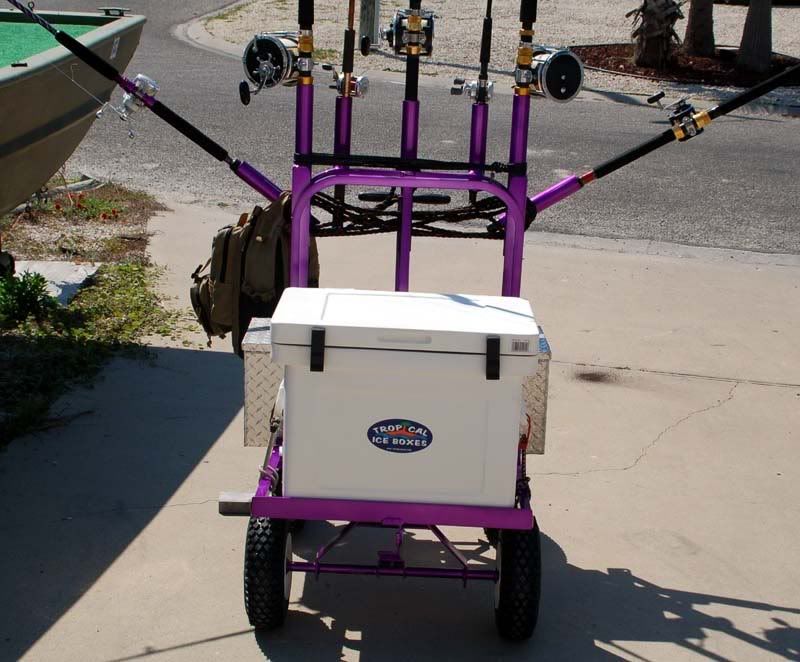

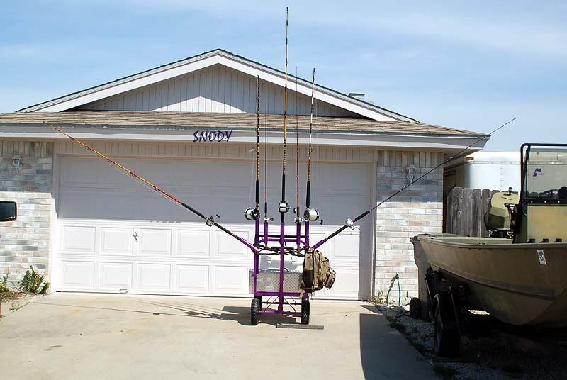

I enjoy tig welding and this one of my custom fishing carts for Pimping on the Pier.
You got to make a statement!
The Pimp Cart was polished, shot with Purple Powder Coat, then shot with gold metal flake followed by three clear coats,
Its dripping wet, dripping money.

Nice threadwork! Nice epoxy work too, that takes a hell of a lot of time and practice to do right, and you are doing it right.
If you pre-mark the corners where the diamonds stop, and make sure to account for the change in blank diameter along the length of the wrap, you can keep them a little more even. Keep those interior threads from getting to cramped at the top and bottom. Try some of the HT metallic threads too, they really POP!
Sweet cart too, but isn't that diamond plate a little over the top? Whacha got in there, money?

PS! Damn you have a lot of DRILL PRESSES!!!

Hey, Mike! Will you put an engine on that cart???
