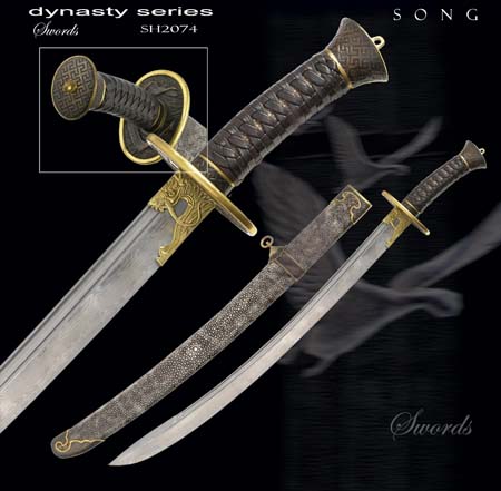

Hopefully this isn't considered a hijack, but does anyone have a link to how to do a Chinese-styled wrap? Like seen here?
I've only been able to find one diagram before, and it gave only so-so results. Given how tight those wraps seem to be able to be done, I'd be surprised if the one I found was authentic.
