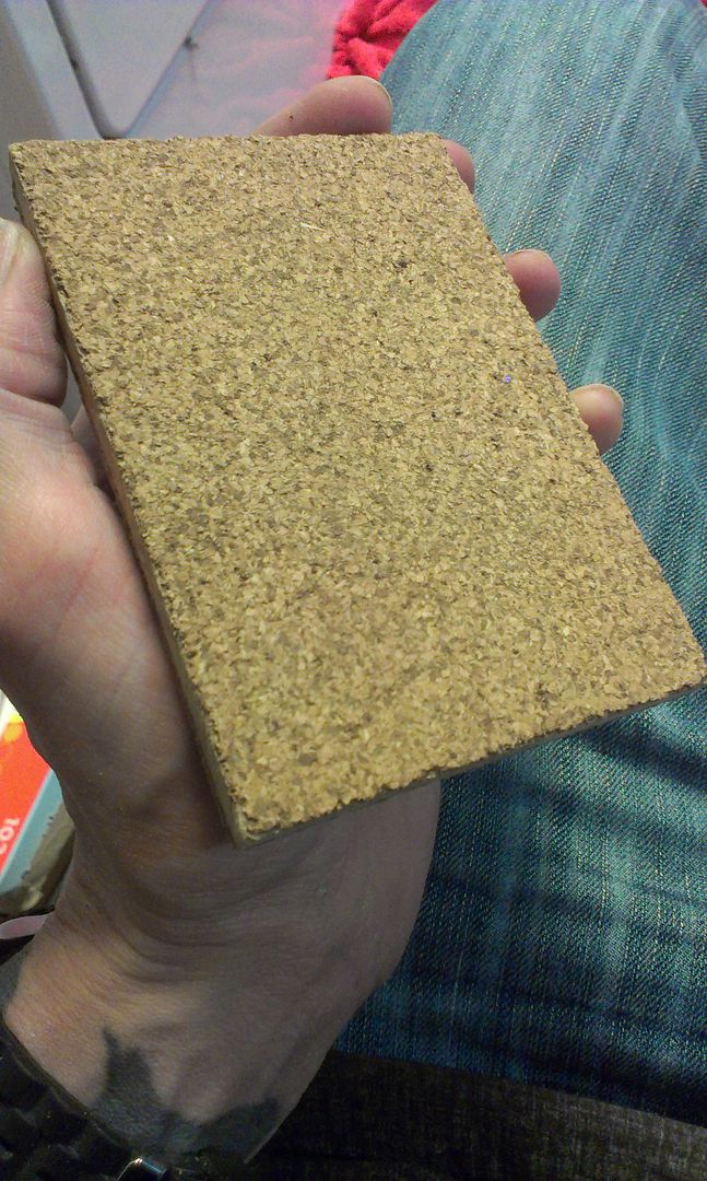

Cork strop question
Jun 13, 2007
7,743
Compound, or no?
ChromOx or something else?
Btw, I got it at Home Depot. It's kinda small but it's a very thin layer bonded to hard wood. It's very flat, but best of all, free. Grab one from the flooring dept. samples.
I'd try it plain first. If you need more aggressive cutting, try CBN for the harder steels, or ChromOx for softer steels..
Thanks man. I'm actually not liking it all that much if I'm honest. I'm use to my leather strops and cork, at least this cork, feels sticky. I'm going to try the ChromOx to see if that helps.
Most wood flooring is stained and sealed with a poly coat on top. Sand it down some and try again?
Thanks! I'll try exactly that. I wasn't sure if my blade was contaminated, but now that you mention it, it does seem to put streaks on the bevel.

It made all the difference. The tactile feedback is completely different and there's no more haze on the bevel. I touched up the edge before I stropped and sliced some paper. I then refined on the cork and it absolutely made a difference.
Like I said, the cork is very thin. Maybe you 1/16" and feels good on a "V" bevel.
If any of you pick one up, I highly suggest sanding it first (or after to see the difference).
Here's a pic of the "strop".
