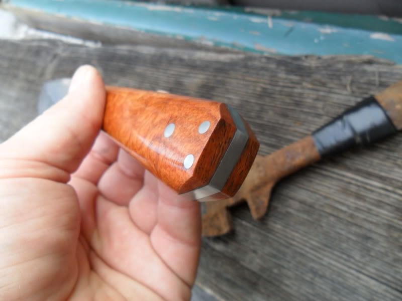

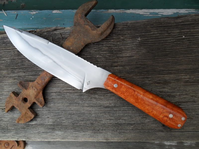

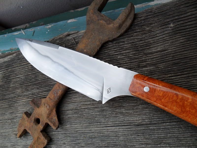

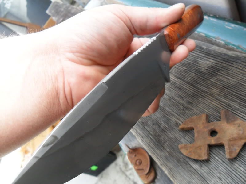

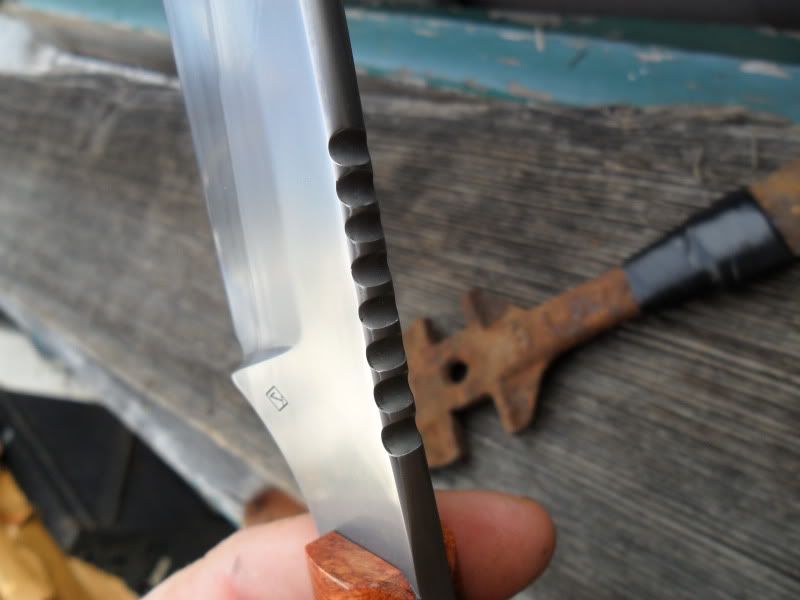

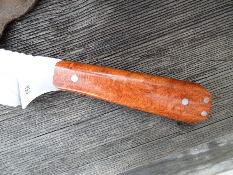

Here is another We are just finishing up for a forum member and local San Diegan.
She was given the name "Corrie"
A new one for us...
3/16 1095
sabre ground with swage grind and file work.
Differentially heat treated, hand rubbed to 800 grit, acid etched
Amboyna Burl scales with 3/16 and 5/32 stainless pins.
Blade length: 6"
Overall length: 11"
Questions and comments welcome
Thanks for looking!
