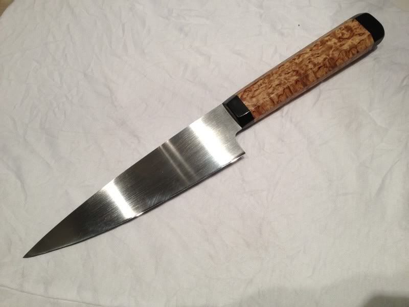

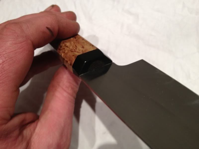

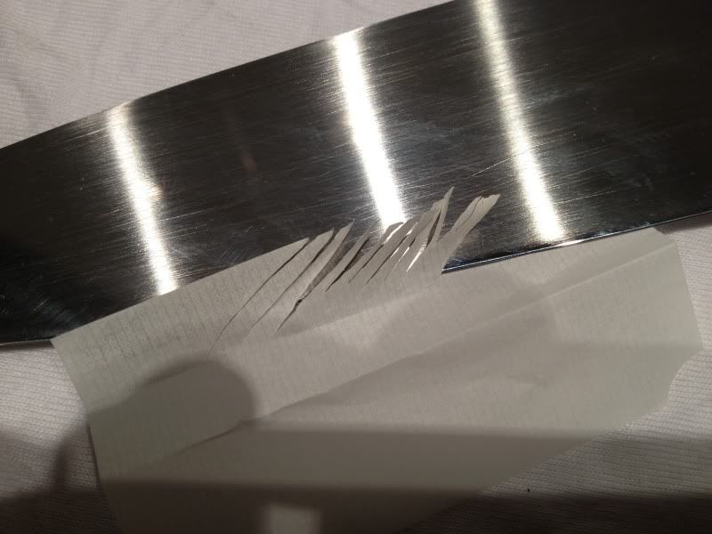

Ive been 'playing' knifemaker for about 5 years. Ive done some complicated damascus work and got quite good at the welding. Got more in tools than you can imagine. Ive made a sword with 9 bars, and can weld stainless to stainless. The funny thing is ive gone back to basics and started to do some simple kitchen knives, im not quite there yet but making some advances. The simple stuff is deceptively tricky!
This is the last one I made, about $10 in materials, prolly the same in consumables. Does not look anything but took all of my knowledge to get it right. Distal taper when the thickest bit of the blade is 2mm, and a full flat zero grind just take practice and confidence at the grinder, the cost is nothing but the experience is invaluable !
might be the first knife ive shown on this forum... be gentle ;)
