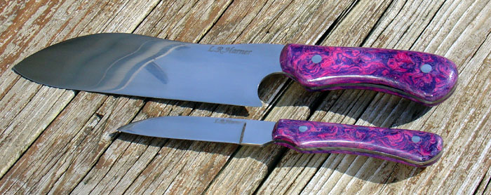

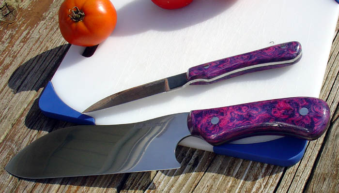

little cpm154 3/32 thick
Rc 61
handmade cotton candy mycarta
Except for the dip in the spine of the chef's knife, looks like a hell of a set!
Especially since, if you worked in a commercial kitchen, nobody could take them without getting caught! :cool:
Now that is cool Mycarta!
Nice work. I'm in the middle of making a set of kitchen knives for my girl. I've been using maroon Micarta. Hope she doesn't see your Mycarta or I'll be remaking them!
I for one like the dip as I know it offers a chefs grip when choking up on the blade.Your micarta is cool.:D
i had been asked about the finger grove and the drop in the spine
the "finger coil" alows for the pinch grip to use your middle finger as a povit ish as that about the blalance point of the knife
the spine drop also makes for a more balanced grip by putting the handle hump up in your hand alittle better without having you index finger bumping the blade
thank you all for the kind words also
