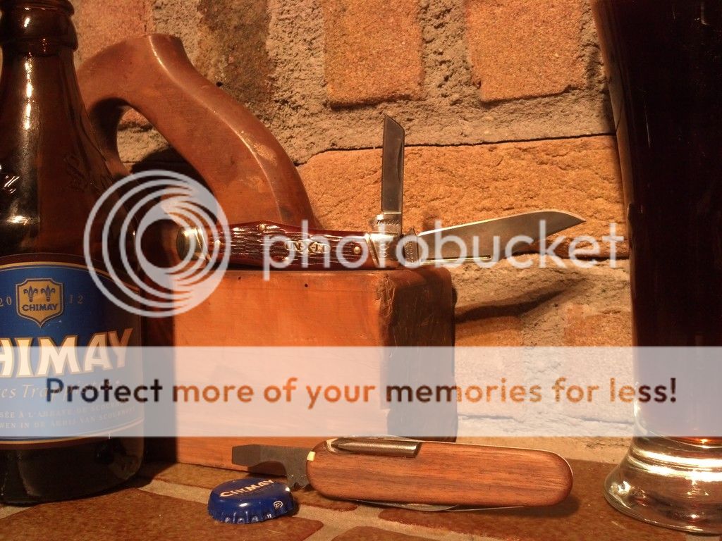

I've modified several of my own knives using a belt sander with a cup of water next to me to dunk the blade in, keeping the temper.
It's slow work--one pass, dunk, shake off the water, check your progress, start over. When you get the shape you want, you still
have to fine sand and buff. It took me a little over an hour to change this Eureka jack from a spear to a clip, and round the spine
of the coping down to more of a sheepfoot. Much more to my liking, now!

Looks good Jeff. Nice job. Glad to see you started the clip a hairs breath before the pull thereby not interfereing with it and that regrindg to a sheepsfoot for the secondary blade is pure class.
Thanks, Ed, I'm very happy with it. My work isn't as clean as sturzi's is, but on a user that I'll never get rid of, never mind.
