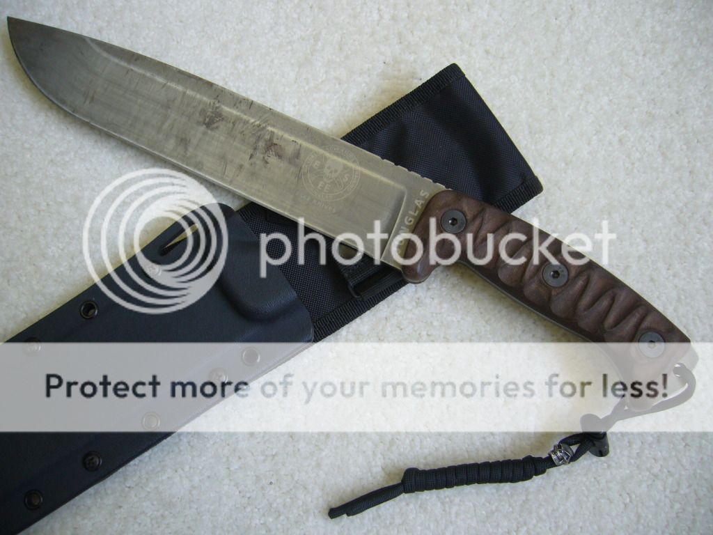

I know how you feel. I just picked this up Friday night. It came with the customized scales. Done by a local guy for the shop where i purchased it.
I love, but have not had the chance to actually use it yet. Maybe this weekend.
That's nice man! Do you have any info on how you did the mods?
Thanks Josh. I stripped the coating on the blade and lightly sanded it with 400 grit sandpaper and then smoothed it out a bit with 1000 grit. I wanted to keep a bit of the logo and lettering showing so I didn't go for that polished look.
As for the scales, I used a dremel with a triangle shaped stone to get that pattern. If you attempt this yourself just keep in mind that you have to be really patient otherwise the micarta will burn. Don't press down hard in an attempt to get it to do it faster, and let it cool about every 5-10 seconds (it took me a total of 5 hours to finish both sides). Afterwards just lightly sand it with 400 grit sandpaper and then dye it with brown rit dye.
The jimping on the top is done with a carbide bit. Just mark where you want to grind, and clamp the blade down on a vise (or stab it into a thick cardboard box. Spray some wd40 for lube and try to be as precise as possible.
