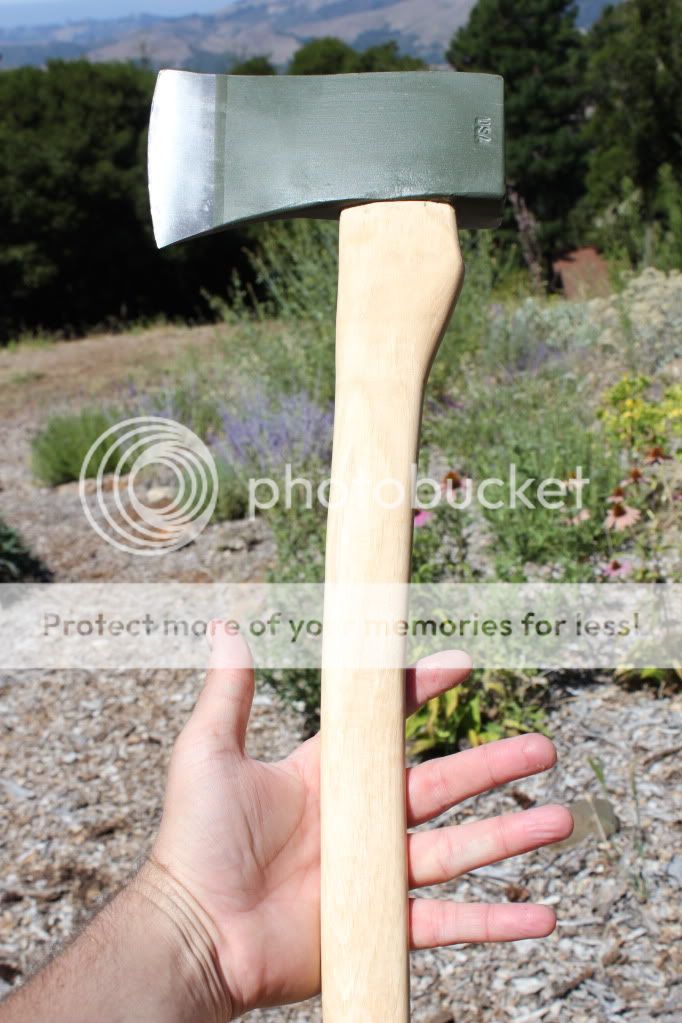

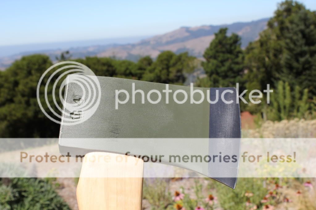

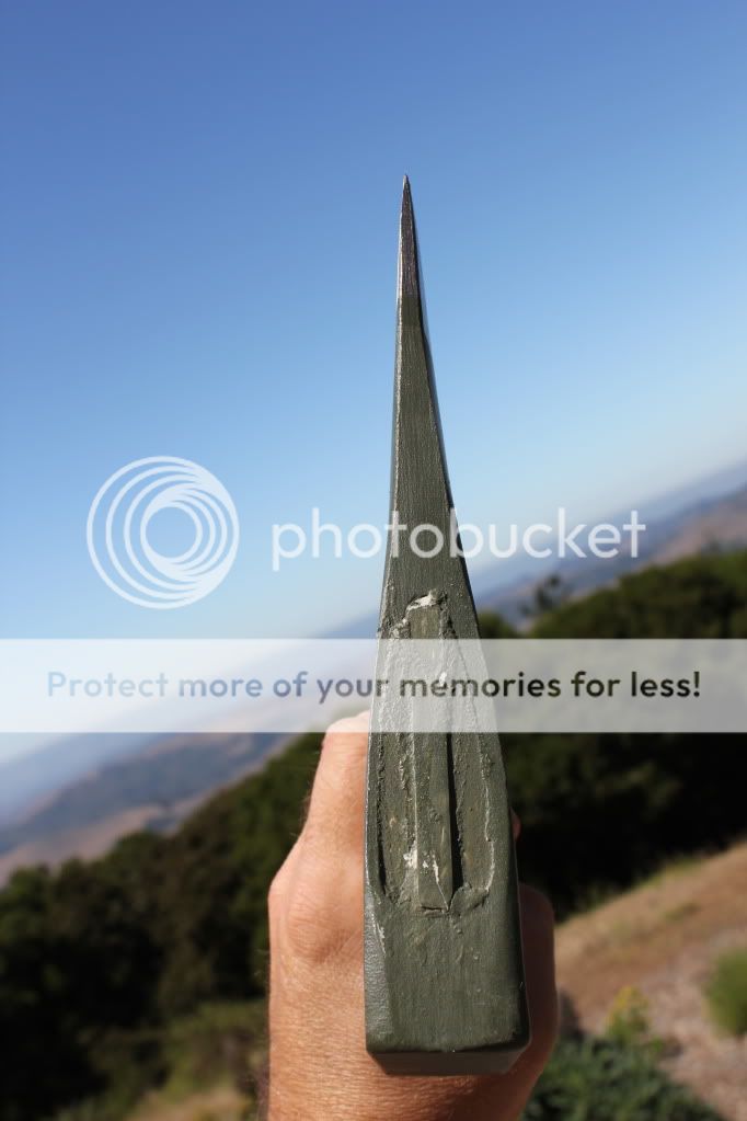

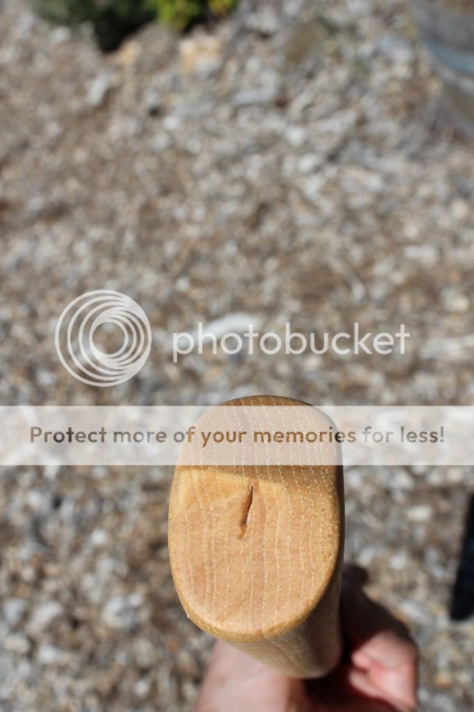

Here's my Council 4lb felling axe. I bought this from an auction site so I'm not positive on which model it is but it seems to be a high quality tool. It just arrived so I haven't had a chance to use it yet.

Council does make good heads and handles. The main problem is with their use of aluminum wedges, which tend to break off pieces inside the eye which leads to loosening of the heads. If you can rehandle them they make heads with good profiles and the steel is tough. The new Velvicut line is very interesting for sure.
