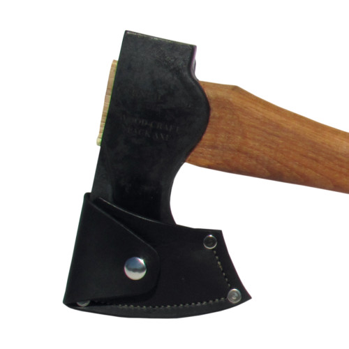

So I came upon this on baileys website and I really like it but there isnt any info on it except whats in the link.
http://www.baileysonline.com/Forest...OD-CRAFT-PACK-AXE-19-CURVED-HANDLE-W-MASK.axd
There is a 24' handle version as well. It resembles an Autine Hunters axe, which is what I have been looking for.(wish I had the funds for an Autine) I cant figure out if this is an new item or one that is being fazed out. When I google it the link to councils website has a 404 error. Just wondering if anyone knows anything about it?

Google's cached page (from Council Tool's website) shows this:

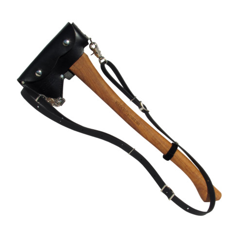

2# Wood-Craft Pack Axe, 24″ Curved Handle, Full Sheath
2# Wood-Craft Pack Axe, 19″ Curved Handle, Full Sheath
2# Wood-Craft Pack Axe, 24″ Curved Handle, Mask
Full sheath:
Mask:
Looks like 5160 steel, with hardened poll:
2# Wood-Craft Pack Axe, 19″ Curved Handle, with a high quality Leather Mask: The Council Tool Co.’s WOOD-CRAFT Pack Axe design is intended to produce a multi-functional premium axe which can successfully cut, chop, split, carve, shave, hew, hammer, aid in fire starting, and other key WOOD-CRAFT and outdoor activities. At 2.0 pounds, the Wood-Craft “Pack Axe” is made using 5160 steel, heat treated on both ends for superior strength, and this model has a 19” Premium Curved Hickory Handle (handle length is before hanging and assembly) and includes a high quality welted leather Mask to protect your Pack Axe from the elements and you from your extremely sharp Pack Axe.
from http://webcache.googleusercontent.com/search?q=cache:XShzP5FldtwJ:counciltool.com/shop/wood-craft/2-wood-craft-pack-axe-19-curved-handle-mask/+&cd=2&hl=en&ct=clnk&gl=us
cached by Google on March 23, 2016
Looks like an improvement on GB's axes - better shape - and with superior 5160 steel for a better price. Good move on Council's part.
Guess I didn't search well enough but it is listed on their web site, but out of stock. Baileys is supposed to have them on 4.20.16.
It sounds like it's a soft-open for the axe. it looks awesome, quite frankly. Good on CT if they perform as good as they look. And that full sheath? Very nice.
I certainly hope that Rooster-mod was in on this because they copied his design exactly!!!
is this the end of the Velvicut?! dangit I keep putting off buying a velvicut!
Well Guys, Council Tool has not publicly launched this first axe of a new line called "Wood-Craft" as of this posting (4/8/16)(which is not replacing any existing line but being added as a new premium line)...I think Bailey's might of unknowingly jumped the gun on the listing on their website...
And yes, I worked with Council on this new design which is based off of a mod that I had done previously on one of their stock Boys Axes...
I really think that there is a demand for this type of axe in the "American Made" market...and it is not intended to compete on an one-on-one basis with any of the Swedish models, but stand alone as an option for guys who want a premium axe that is home-grown in the USA...
I am more than happy to talk about this axe if anyone has any questions, but keep in mind that it has not been publicly released as of 4/8/16 .
Thanks and Axe-on!
Peace, Rooster
$157.77
$155.97
$142.20
Full sheath:
Mask:
Here is the link to true pricing from Council Tool....in case you would like to edit your original posting.. Peace, Rooster
http://counciltool.com/new-wood-craft-axe-line/
