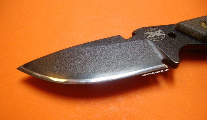

Your HEST is Beautiful!!! That's exactly what I've been thinking of doing to mine but I"m also tempted to clear the spine for firesteel striking... anyways just wanted to say NICE!
Here's my edc/man-bag HEST with a convexed edge... I find with the ESEE's (and I imagine the same with heavily coated tweeners) that just taking the shoulder off above the blade makes all the difference in the world when cutting.
Eli
Thanks GT. Coincidentally, I have been convexing my H.E.S.T. for awhile now (doing it by hand) and I just got it out to do a little more work on it, when I thought I'd pop in here to see if anything was going on. I had convexed it earlier, but I decided I wanted to run the convex edge up a little higher, so back to the 220 wet/dry. I'm almost finished with the 220. I think it's going to work well.
