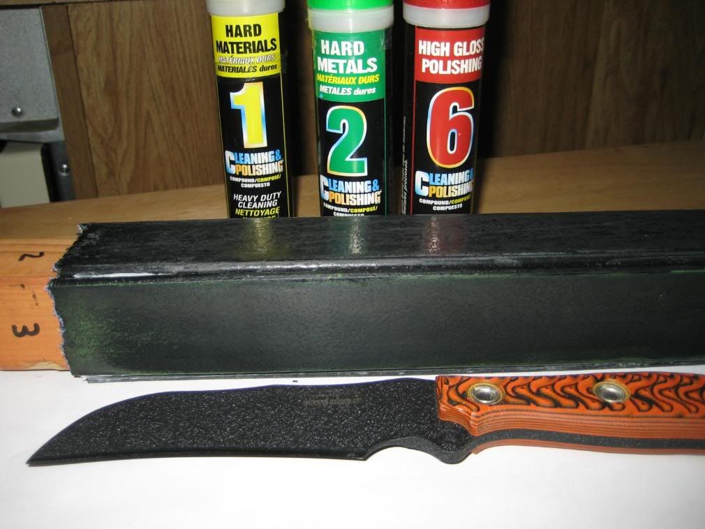

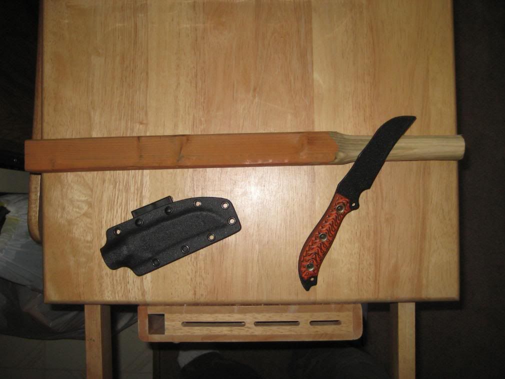

Some Busse content making the strop bat.....
I only use the green aluminum oxide now, which funny enough comes in the red #6 marked container. Very cheap. That tube cost $3

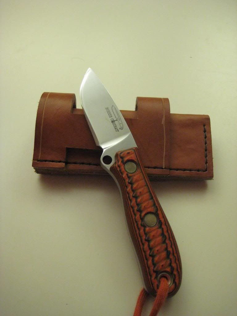

Factory SS edge with no refinement, outside a few minutes on the strop.
