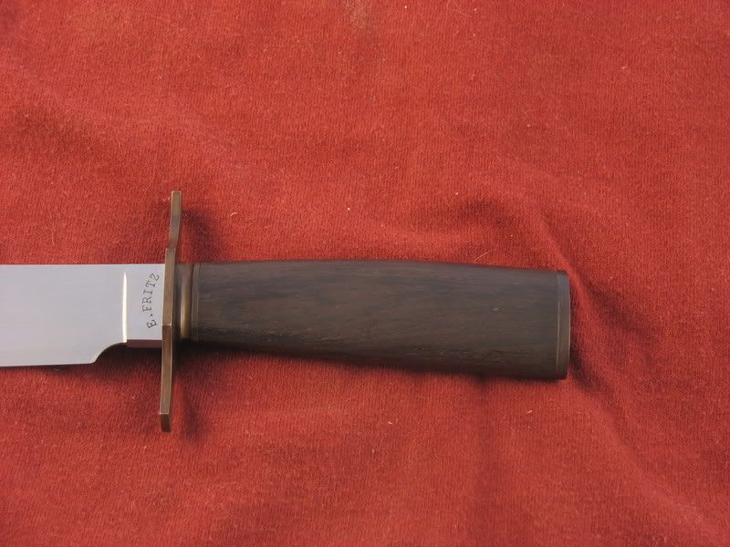

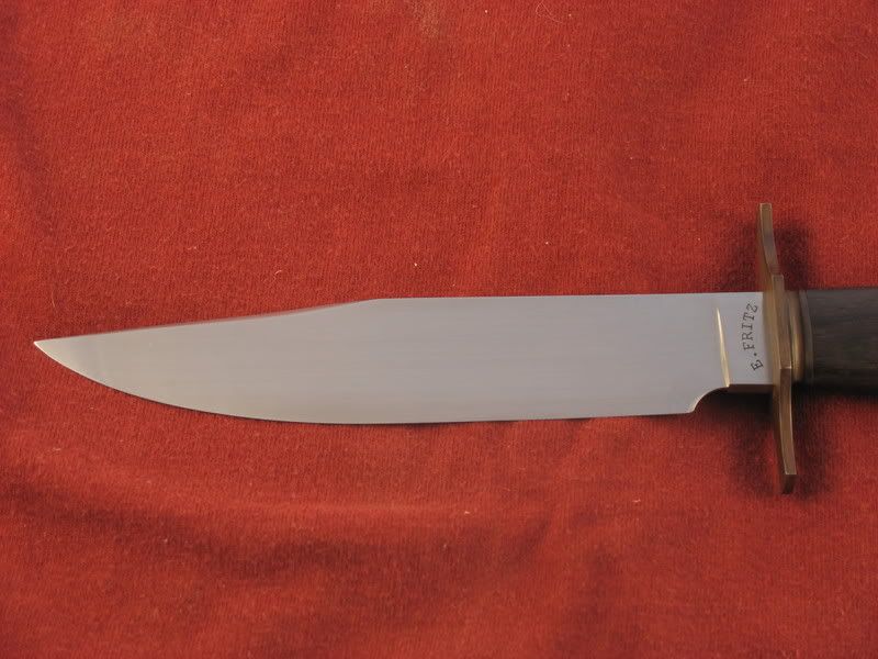

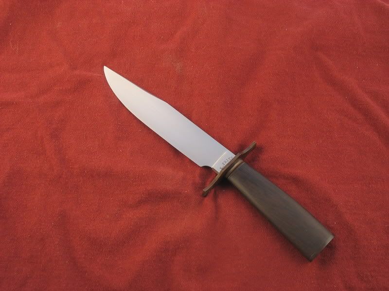

Here are a couple of new knives just finished. First up is what i would call a cowboy bowie. this will be one of my BLADE SHOW knives. it has a 1084 blade mild steel fittings that have been browned and an african blackwood handle. this is my first through tang knife and took me 5 weeks to get it just the way i wanted.

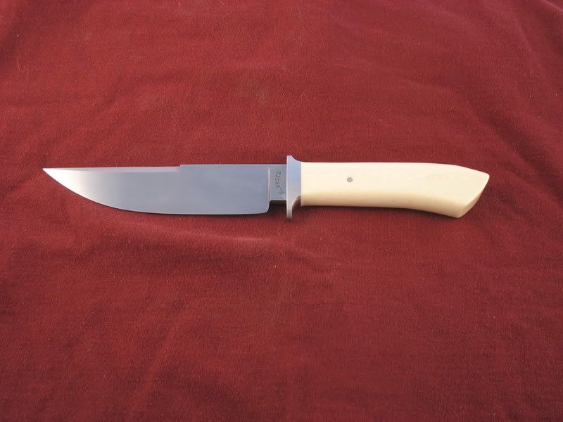

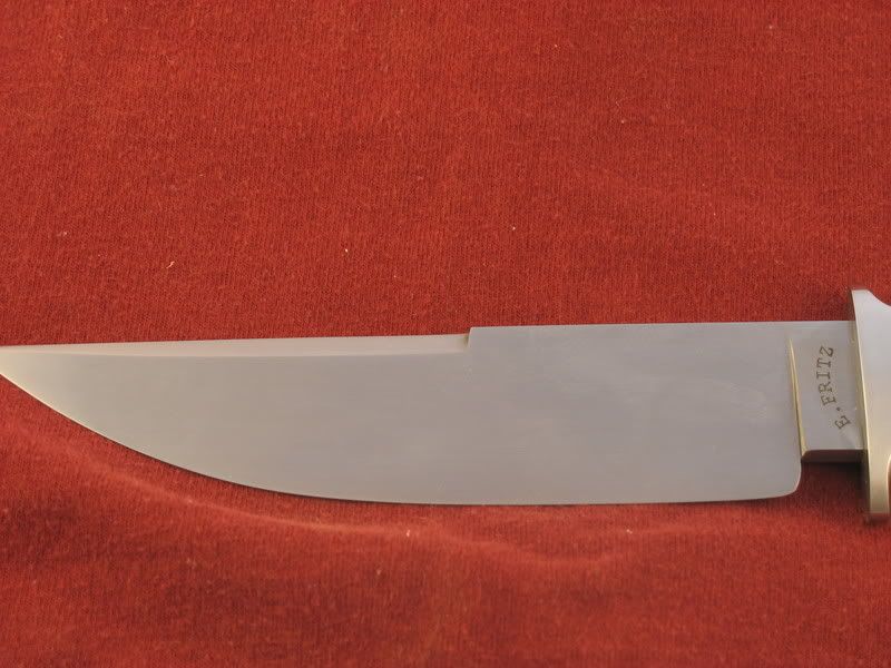

Next up is a one of my "Forged Chute" knives that seem to be somewhat popular as of late. it has a forged 5160 blade with 416 ss guard n/s pin and a TRU-Ivory handle. wasn't real sure about the handle but it is what the customer wanted. He is a retired SWAT officer from Pennsylvania and wanted a showy knife to wear at gatherings. let me know what you think. I tried to talk him into actual ivory but he wanted something more stable.
