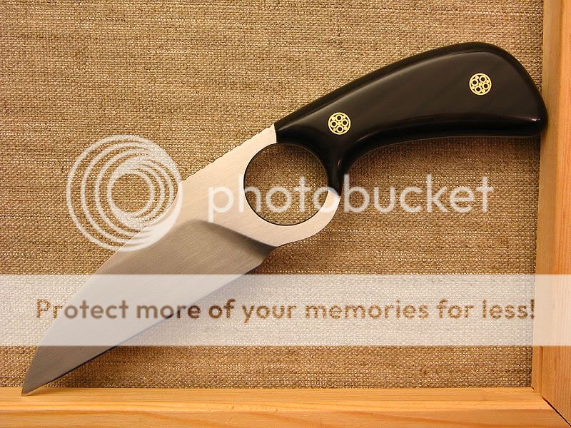

My latest creations.
2 Ring-knives with different handle and blade style.
Lenght is about 6,5". thickness 0,16".
RWL34, 60 HRC, 800 grit satin finish.
Handles are made of grade 2 titanium secured with torx screws and buffalo horn with mosaic pins. I love ring-knives, they are fun to make. Although i urgently need to get a hole-saw for the finger hole. It will probably save me more than one hour per knife. :D

I was thinking about having them laser cut already. Its probably economical, if make 10 or 20 of them. :)
I will definetly check some prices!
Which other knife? :D
1st is titanium anodized (red-gold-something)
2nd is buffalo horn.
