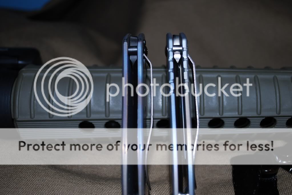

I scored these from a fellow forum member here. You guys have me all wound up just sitting here and looking at all the cool "mods" and "pimpings" and "goings ons" in regards to "making a knife your own".
...so I thought I would jump in. I know it's not much compared to some of the excellent work you guys post up in here, but I figured, you gotta start somewhere, right?
Let me know what you think...

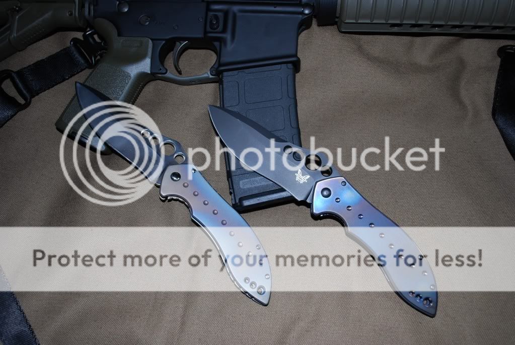

Both knives were sorta "projects" for the previous owner, so they turned out to be perfect for my needs. I found out some very interesting things while playing.

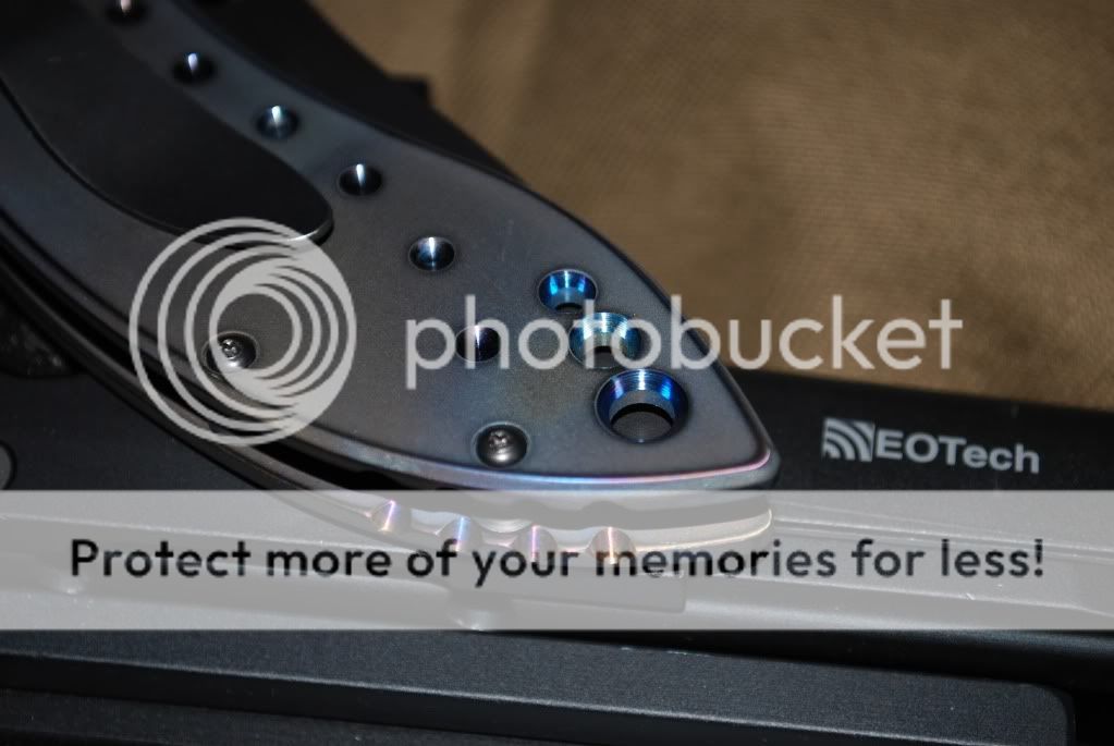

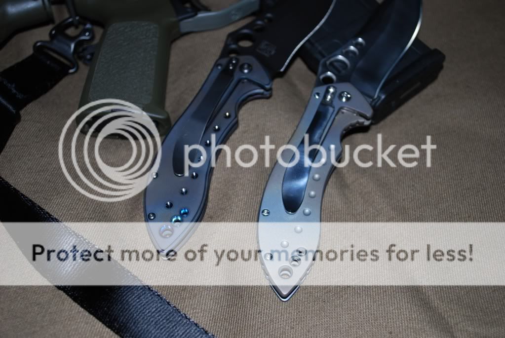

I heat "anodized" the handles on both units.
On the unit with the black blade and hardware, I hand sanded the Ti and polished the edges only. The polished surfaces took on lots more color than the rest, and the sanded surfaces almost turned out like what I am calling "industrial" looking. The blade has seen almost no use, and the pocket clip is showing some light wear which produced a real cool "urban/industrial camo" type of finished product. I am very satisfied with this one.

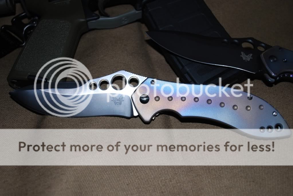

On the unit with polished blade and hardware, I bead blasted the Ti and polished the hardware and blade. Previous owner had "sanded" the blade for a matte finish...so I spent quite a bit of time bringing it around to the polished state that you see before you. There are still a couple of very faint lines from the sanding, but all in all I am happy with the blade. As for the Ti...well, the bead blasting makes the heat anodizing take on a completely different look. It looks more subdued and almost "3D". I reckon because of the different heights left behind from the blasting. I think it looks very cool, almost like a faded tie-dye t-shirt as compared to the other unit which more closely resembles a fresh tye-dye shirt prior to washing.

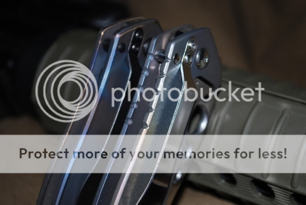

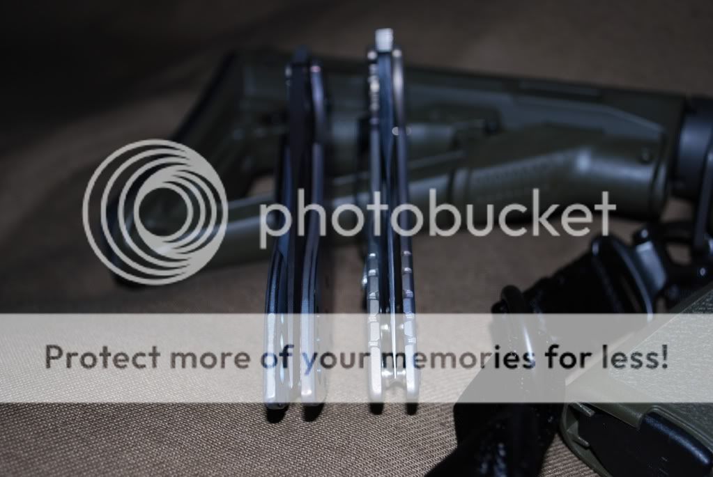

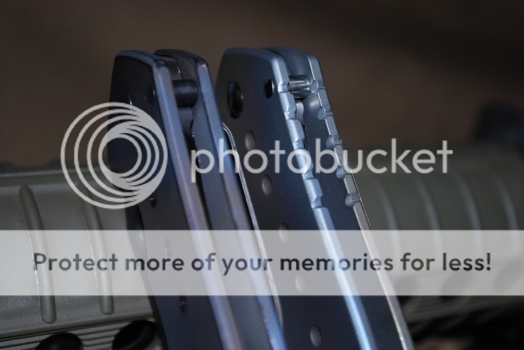

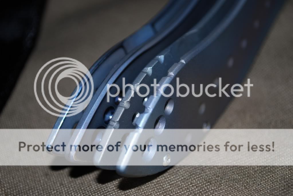

I also tried my hand (literally) at some file work. I shot these 2 units side by side so you could really see the difference between a mostly stock 630 and one with extra jimping. I am a big "Hinderer" fan, so I tried to kinda/sorta emulate Rick's jimping. I didn't cut as deep as Rick's, and I added a round divot to the inside edge coming off of the flat file work to match those that were already on the knife. Man...that Ti sure eats up some files!!!
