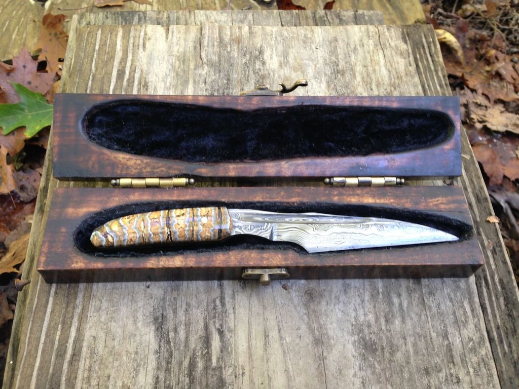

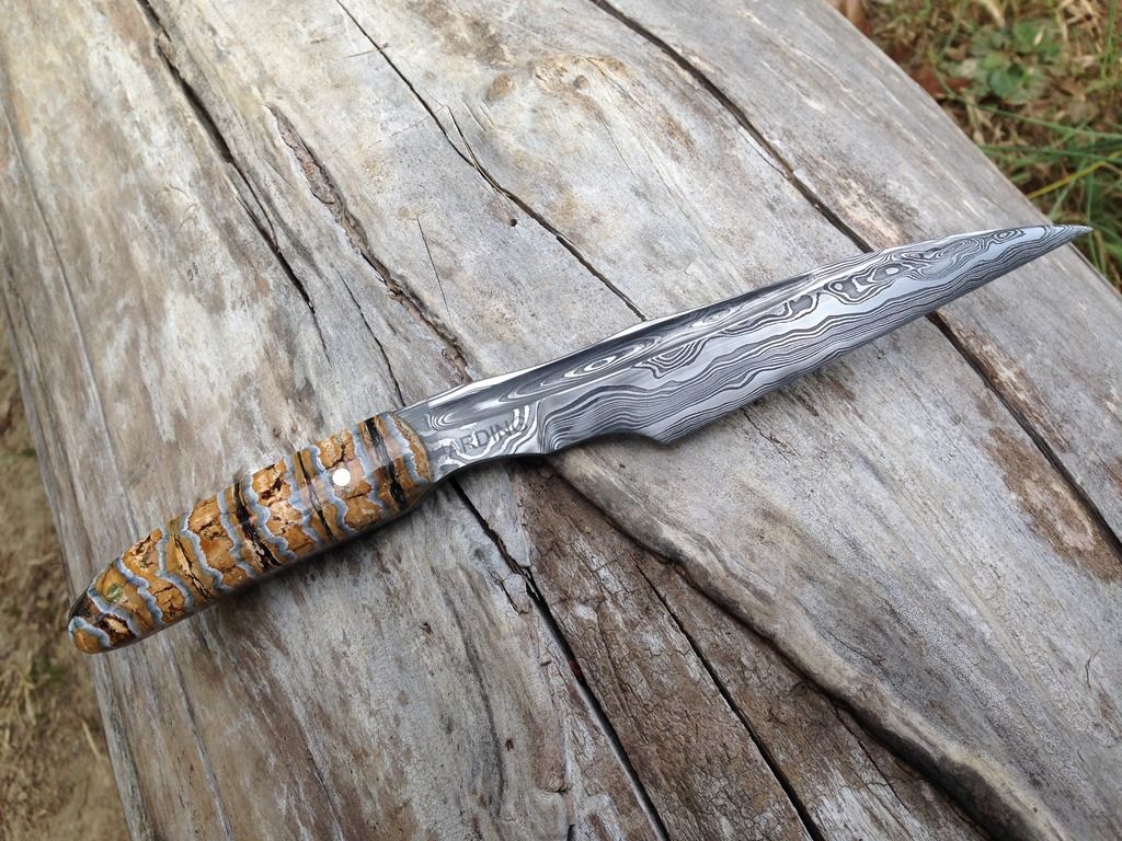

First is my take on a kiridashi-83 layer with mammoth tooth and a curly maple display box

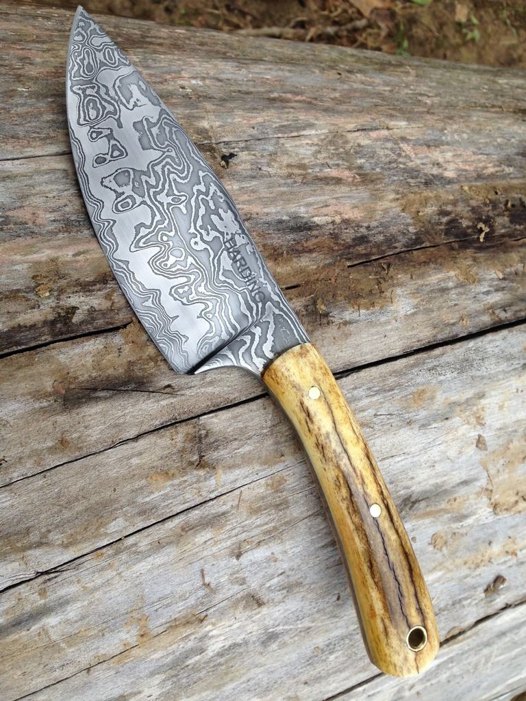

Next is a small hunter/EDC same billet as above with some ancient elk

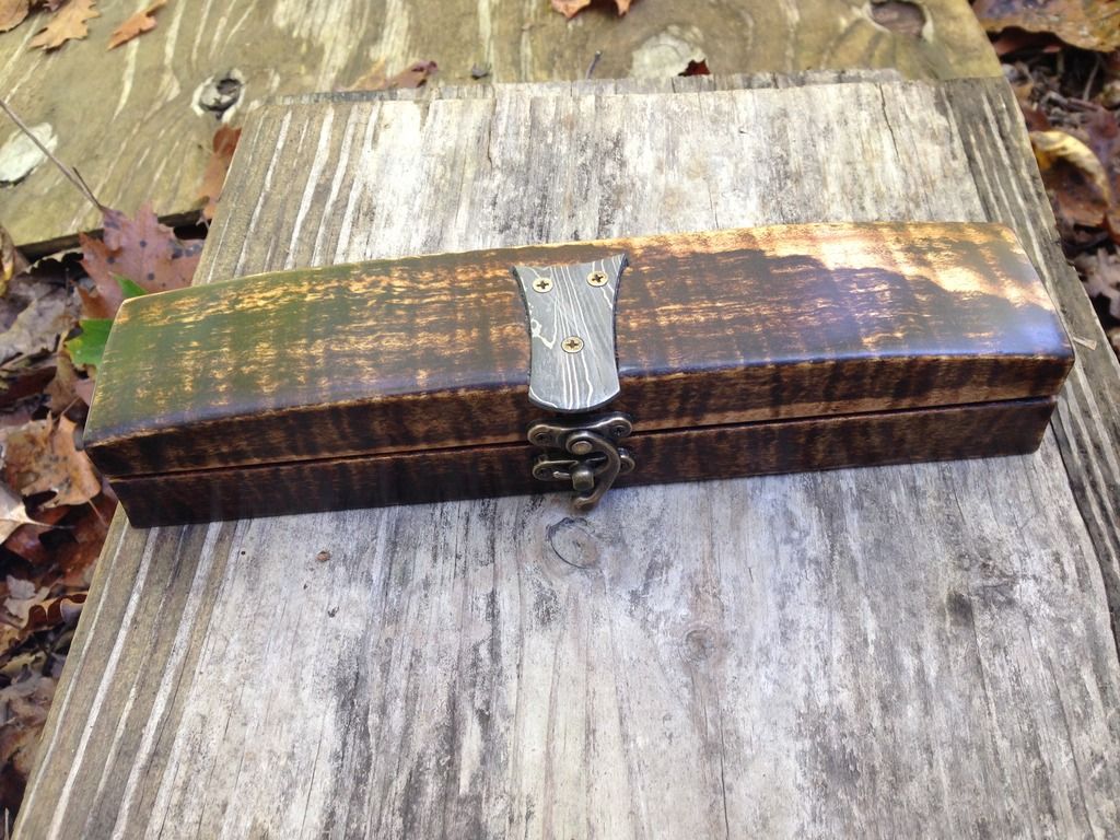

Thanks so much! Its just crushed black velour, I burned the exposed edge of the box cut out to blend and hide the fabric edge
Did you "carve" the knife cavity out of two solid pieces of curly maple?? That is simply stunning....well done!!
Yeah, just used an end mill bit in my drill press and moved the pc by hand, just some 1/4 " foam under the velvet. thank you
