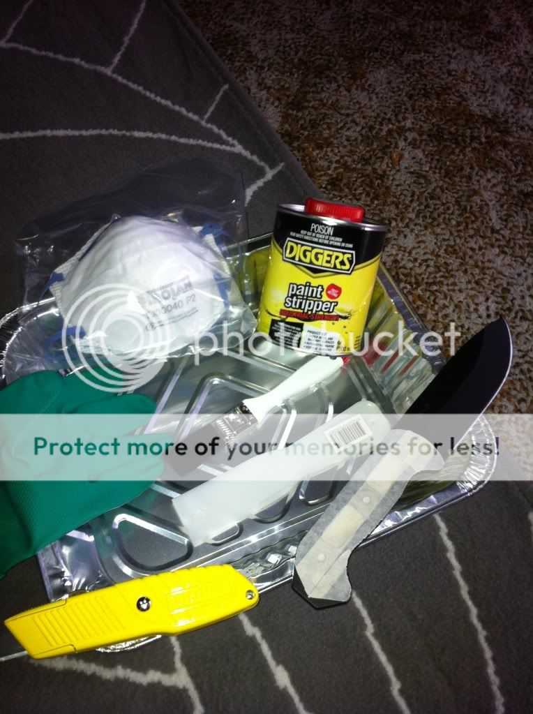

Now that I've got your attention:D I finally got around to stripping my 2.

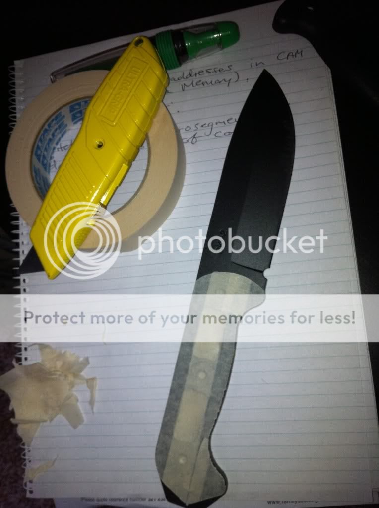

Used painter's(masking) tape so coating under handles could be retained
Tools needed, only thing not shown is eye protection & sandpaper with grit of choice(I used 1200)

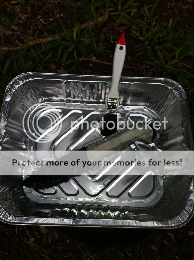

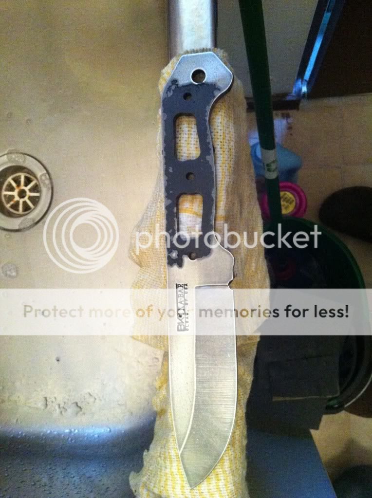

after about an hour or so, lost track of time studying for a Cisco exam...:eek: You can just about make out the coating 'bubbling' off the blade. Sorry crappy phone pics!

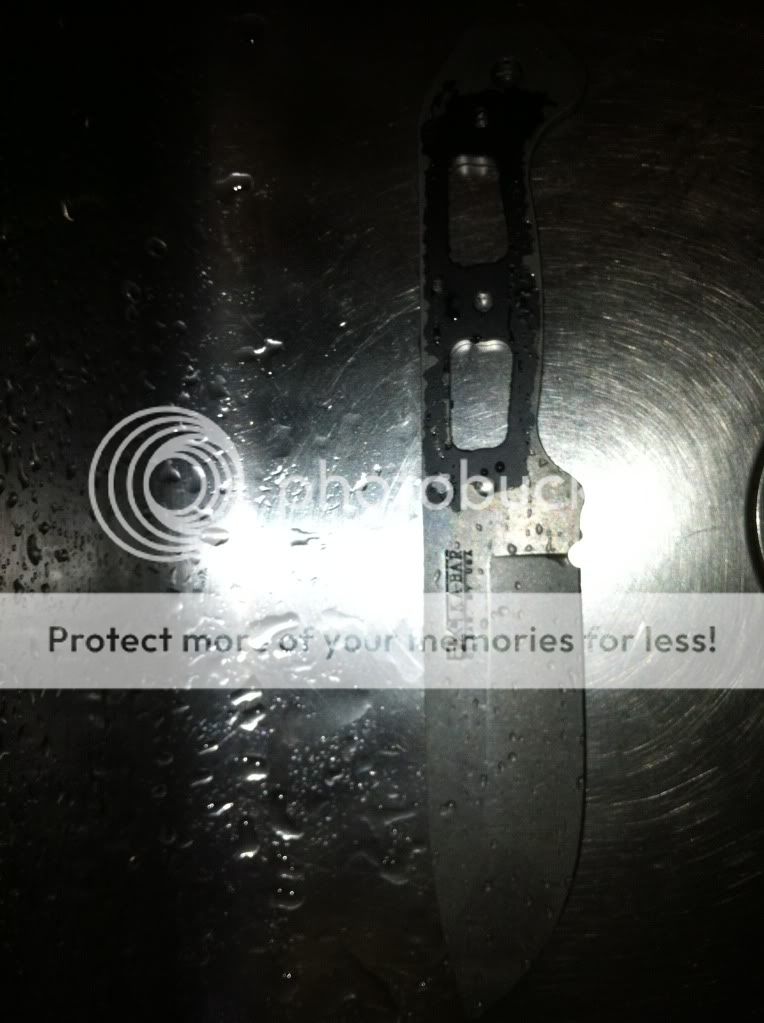

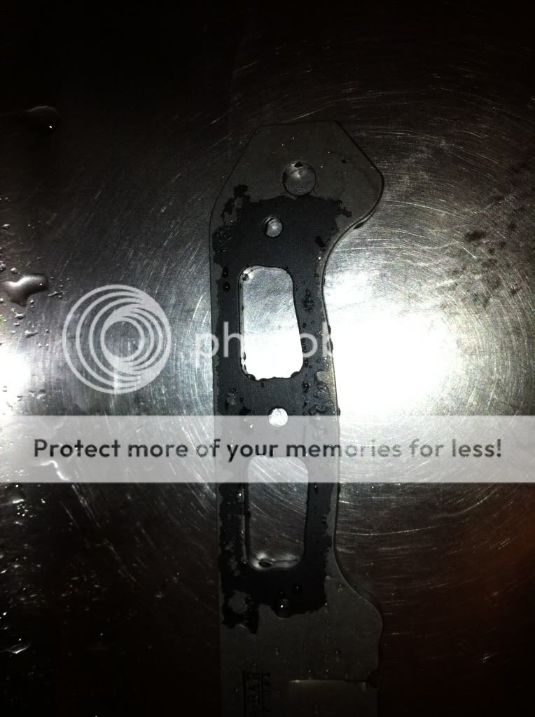

this is how she looked after scraping with plastic scraper & water rinse. You can clearly see the painter's tape didn't do a good job. So heads up to you guys out there planning on strippin. Unless I used wrong kind of painter's tape, I went the el cheapo route. Duct tape is a definite NO NO.

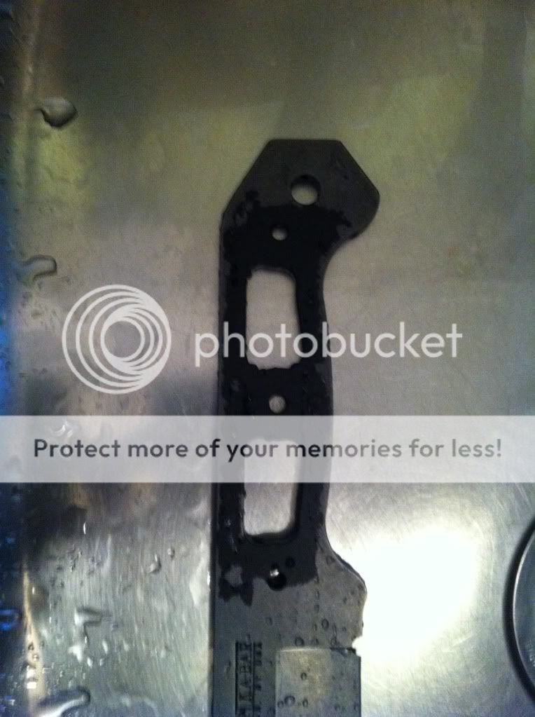

After sanding with 1200G. Decided to keep left over patchy coating under handle.

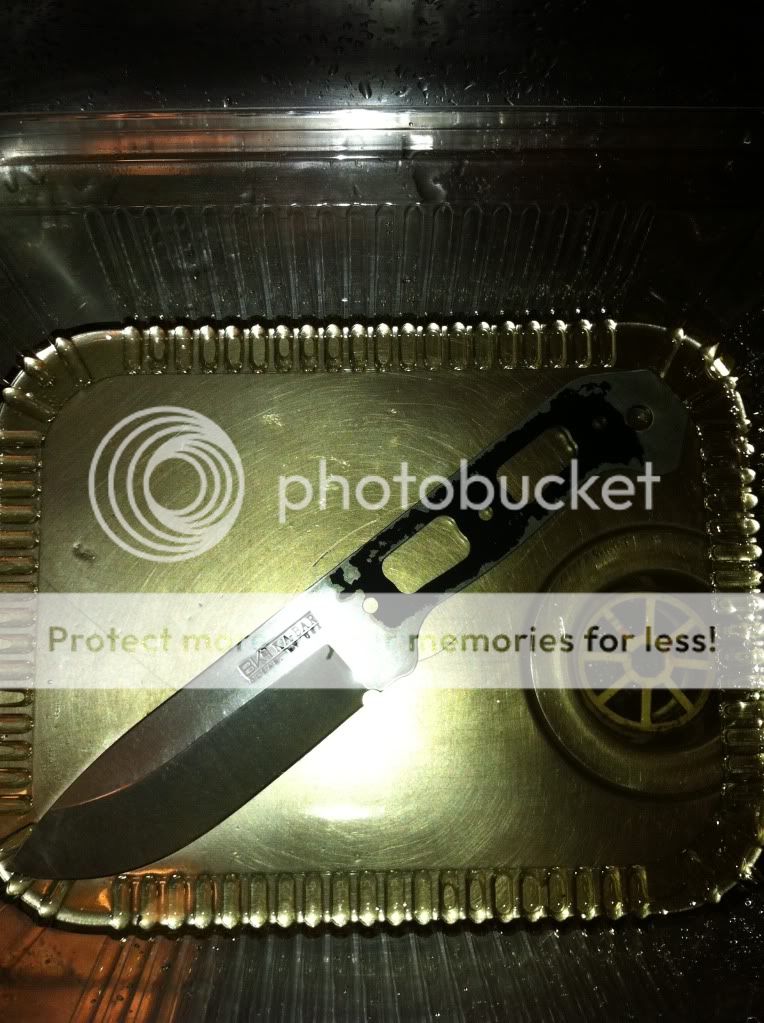

Apple cider vinegar soak for a few hours, which is way to long, an hour max is good. When I removed from vinegar I was able to remove a layer of patina with just a cloth. It doesn't show in pic but you can actually see the vinegar bubbling as it reacts to the metal.
Then another round of light sanding with 1200G as I wasn't happy with patina(too dark due to me leaving in vinegar for too long). Sorry again for crappy pic!

I'm gonna use my vast powers of perception here and guess you taped the handles cause you wanted to keep the epoxy coating on. It may help you to know that in addition to the tape, I've found screwing the grivory down tight did a great job of not removing the coating. Also semi pastes with fast working times a must in addition to brushing the stripper on not soaking the blade in stripper. just my .02

yeh the tape dont work, stripper is some nasty stuff. if you wanna protect under the handles put 2-3 very light coats of poly underneath the scales. looking good man.

The thing is man, It does work. There's just a certain way it works and a bunch of ways it won't.
Looks great, and I want to repeat two things that cannot be emphasized enough...
1. Stripper is some nasty stuff (The stuff I use made my "chemicals-proof" nitrile gloves bubble up and melt)
2. Don't, and I mean DO NOT use duct tape in combination with stripper. I'm not a chemist, but I know it's one hell of a gooey mess.
