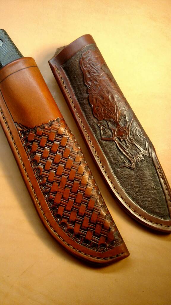

Put this up on another forum but feedback is always appreciated and needed.

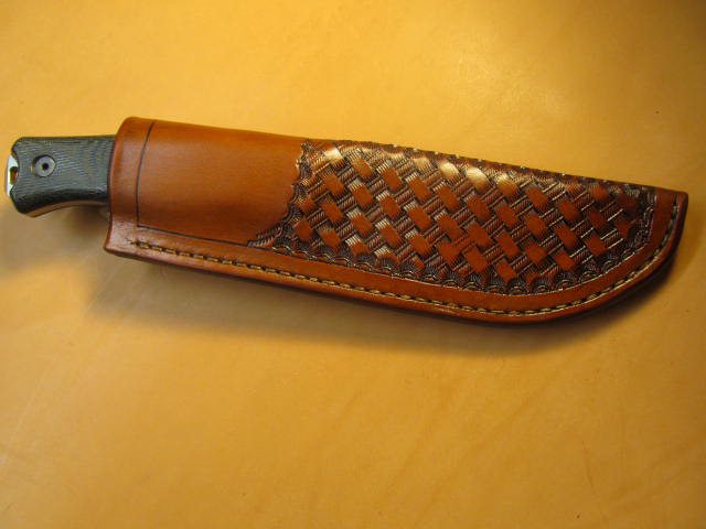

This is how I did a sheath for a Carothers Performance Knives Field Knife. Superb knife, second sheath I've done for one. Props as always to Paul Long's wonderful DVD's and helpful comments and pointers here on the Sheaths subforum, Chuck Burrows Custom Knife Sheaths DVD, Dwayne Puckett aka leatherman of Armorall Leather for his advice and conversations, and a myriad of other fantastic resources available online. This is partly a tutorial, partly showing what I do and opening it up for criticism or advice.

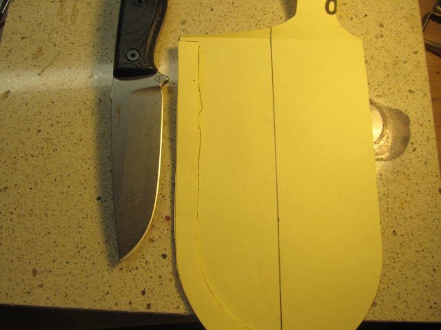

I didn't decide to start taking pictures of everything until I already had this one transferred to manilla stock. Pattern making is probably worth it's own separate topic in any case. Basically I made a center line on a piece of graph paper, drew another line a half inch off that one, and traced the knife outline. I marked a 1/8" gap along the outside of the outline to allow room to fit into the welt, then drew another line 1/2" off that to allow for a full 1/2" welt. It's then folded over carefully to mark the other side then the belt loop is drawn in. Keep in mind that if you want to add a dangler loop you'll need to account for that in the size of the loop. Transfer it to some kind of heavier stock if you want to keep the pattern around, make sure you transfer the center line over also.

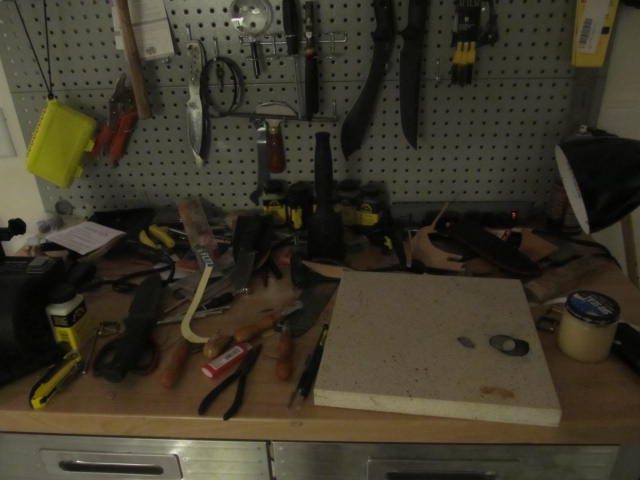

Make sure you have a clean, uncluttered work space. Or, this, crammed into your kitchen

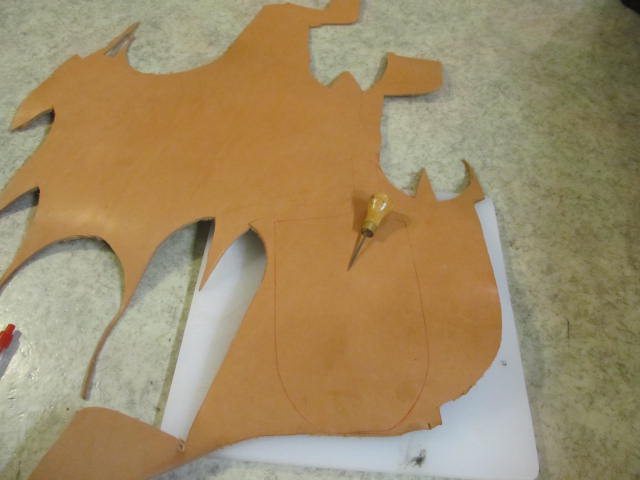

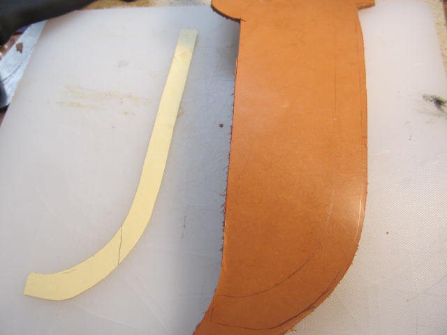

The pattern is carefully marked out on the leather. I use 8-9oz veg tanned leather from RJF leather and I need more. Gotta start shaking my money maker on the corner or something. Mark the center line with a couple jabs from an awl.
I use all of these to cut out the leather. The round knife is the best in general for me but this particular one from Tandy doesn't hold an edge worth a dang.

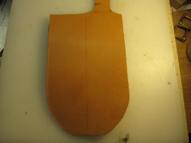

Cut out and the center line marked. Red ink doesn't show up through any of the dyes I've used and you'll be cutting it anyways. Do not mark all the way to the edges, stay 1/2" away. Going from that pic ^ to this one is my absolute least favorite part of the process.

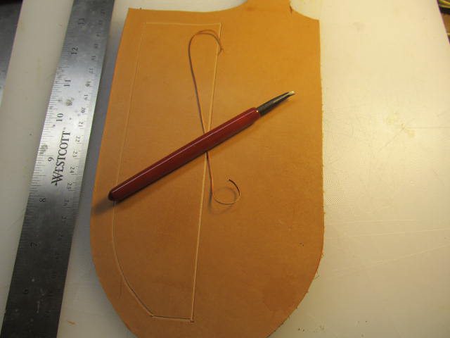

Using this stitch groover I cut the marked center line, using a straight edge to keep the line nice and crisp.

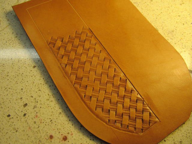

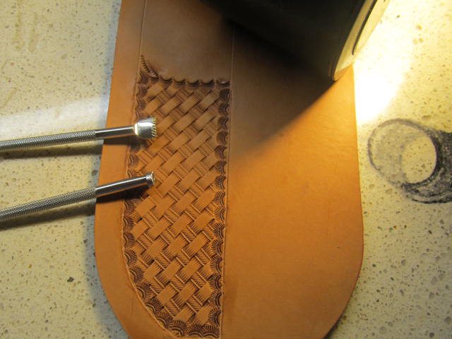

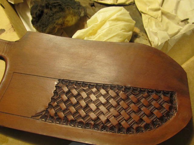

I marked a light diagonal line and started my first line of offset marks with my basket weave tool, in this case a Craftool X510S. I flubbed one of my marks and will have to correct it as I go along. You will have to tilt the tool to get close to the edge but you don't have to try and go all the way there.

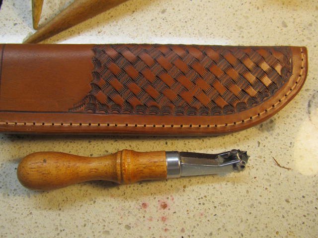

Basket weave portion completed.
Next I used a D436 border stamp tight up against the edge that was beveled earlier. Put a couple other lines above it just because with a veiner tool. I think that's what it is called anyways.

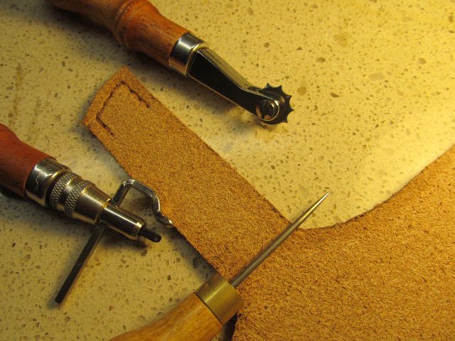

Using the adjustable stitch groover again a line is cut for the stitching on the belt loop. Stitch holes are marked for the stitch holes with the adjustable stitch groover then deepened with an awl.
Connecting the two sides. The holes will rarely come out perfectly spaced, I opt for more, tighter stitches if this happens.

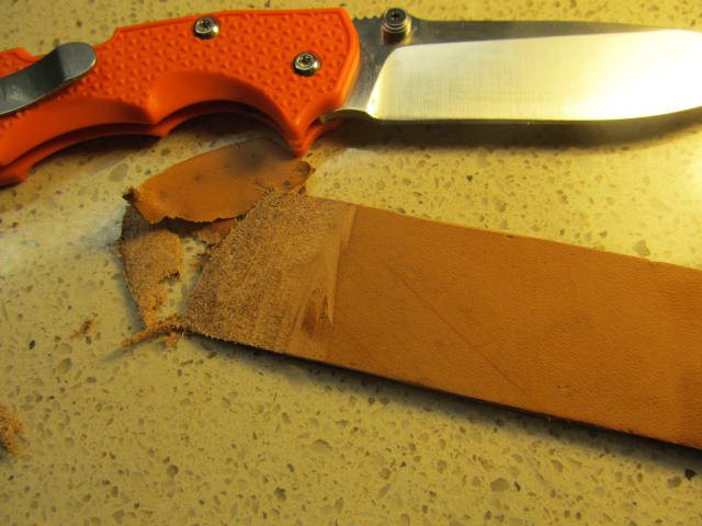

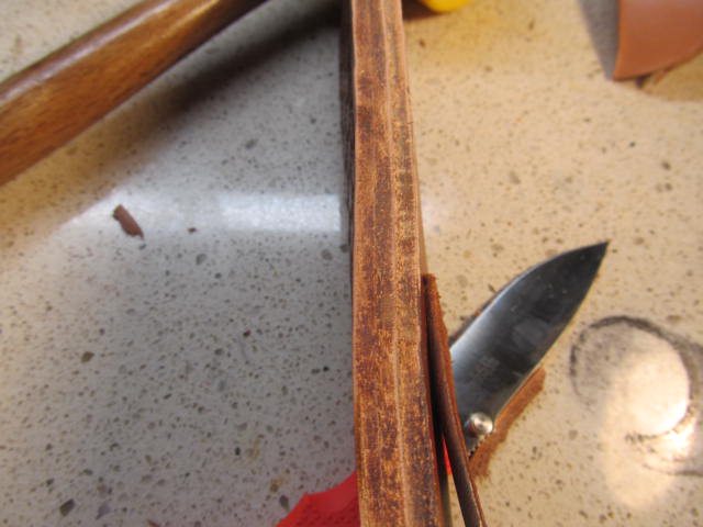

Skiving the end of the belt loop down. A skiving knife would be great but this Boker USA knife takes a fantastic edge and does well.

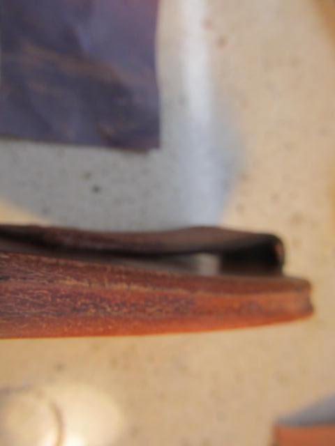

Using a number 4 edge beveler I knock the shoulders off along the sides (NOT the tip) of the belt loop and along the portion that will form the throat of the sheath.

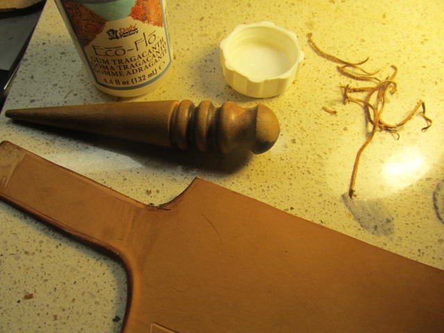

Since it'll be difficult or impossible to do later I use my wooden edge slicker and gum tragacanth to smooth up the edges of the same part just beveled, smoothing the outer edge of the tip of the loop also.

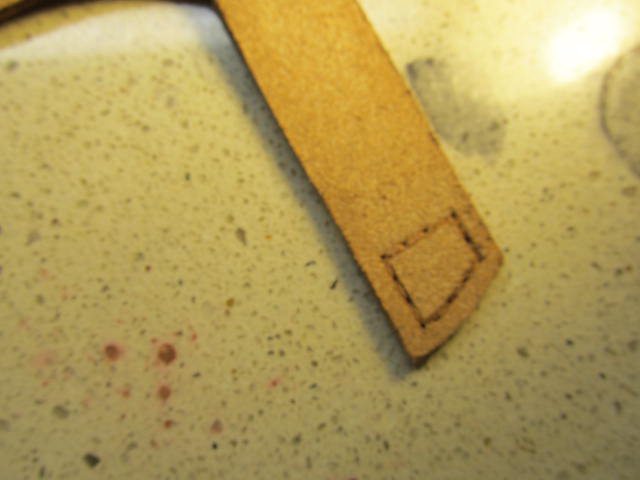

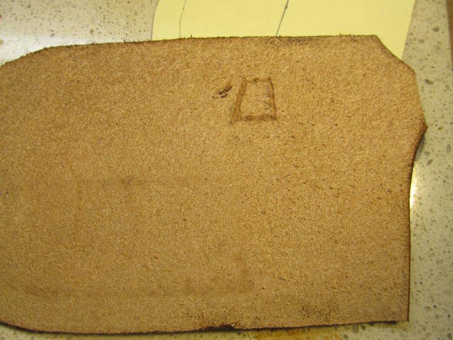

Fold the belt loop over and mark the area that was marked to be sewn earlier then use some sandpaper to rough up this portion. The area that is going to be covered by the belt loop gets some Montana Pitch Blend rubbed in- again it'll be hard or impossible to do after the loop is formed.

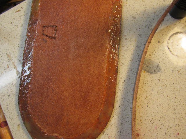

Time to apply your adhesive of choice. I use Weldwood contact cement or barge cement. Once applied it needs to sit for at least 15 minutes. I usually apply a couple coats then start a timer.
Once the cement is ready the loop end is carefully lined up then firmly pressed into the sheath portion then tapped down with a mallet. Try not to hit the sheath like my dumb ass did here.
I usually let the cement cure for at least a couple hours if not overnight before I work it any more but I'm not sure that's really necessary. I definitely wouldn't put any pressure on it right away though. I use an awl chucked up in my drill press to punch the holes marked earlier then on the interior of the sheath I use the stitch groover to recess where the stitching will go. Don't want that sharp as sin knife to catch on and cut the stitching.

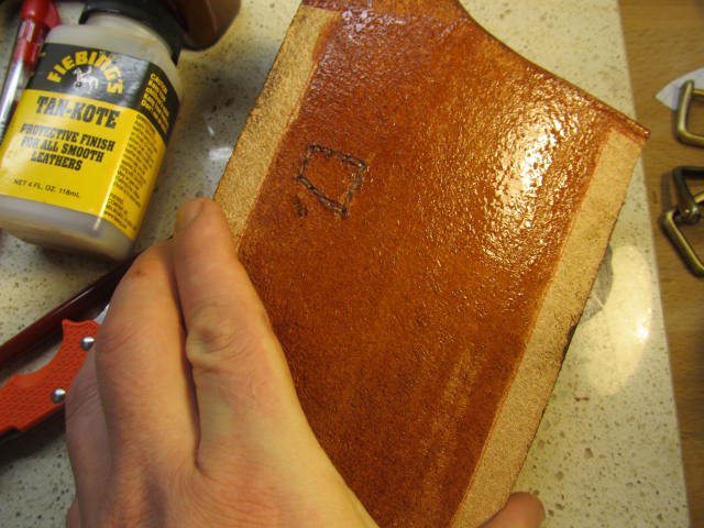

I mark on the interior of the sheath where the welt will go then apply a coat of Tan-Kote everywhere the welt will not be right on up the belt loop, staying off the exterior of the sheath elsewhere. If you want to skive down the center to get a tighter fold on your sheath this should be done beforehand but I don't find it necessary.

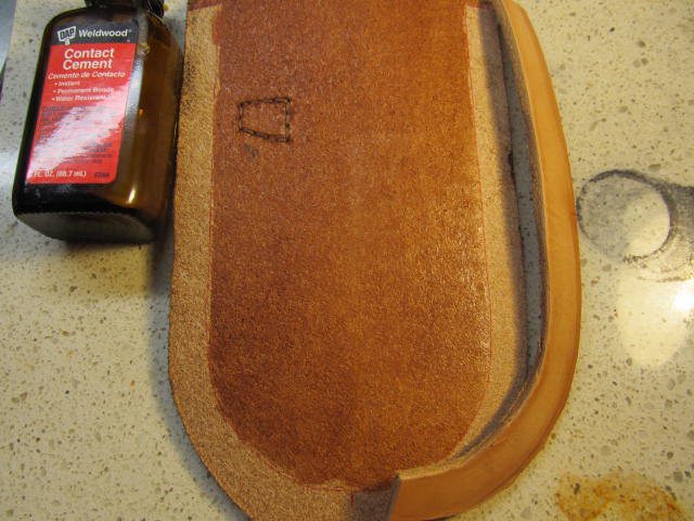

Two coats of contact cement down. This is messy and usually drives me a little crazy. Trying to find a way to set the welt down without one of the cemented sides being laid down on something is frustrating, I've stood there like an idiot holding it for 15 minutes before. I forgot to apply Tan-Kote to the interior of the welt portion before and do it while the cement dries.
Leaving room for the welt to fold over I lay it down along the front of the sheath first then fold the back side over. Then it gets a little judicious beating from the mallet.

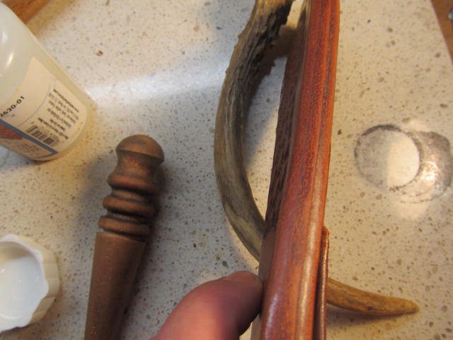

Gum tragacanth and the wooden slicker applied with a heaping amount of elbow grease.
Desperately seeking tennis elbow now, with a piece of antler this time.

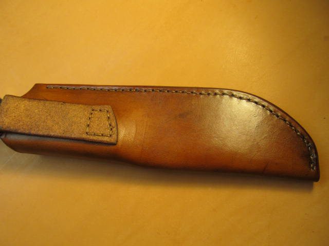

Then I treat it like a pair of boots needing polished, buffing it in with a shoe brush first then a cotton T-shirt. And here it is. It's not perfect but it is a dang fine piece of work. Few things I've done feel as satisfying as finishing a project like this and being pleased enough with the result to share it.
Here's the back side. I forgot to mention that before sewing you want to really dig in with the overstitch wheel to recess those stitch lines as much as you can, back and front.
If you're still awake through all of that, thanks for following along! It'll get a couple more coats of the Montana Pitch Blend but it's ready to face the world now.
