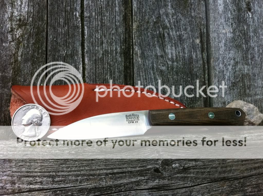

I recently purchased a New Bark River Little Carver in CPM 3V. I had posted a thread a little while ago asking for information about this steel and due to the many positive responses I decided to try it out.

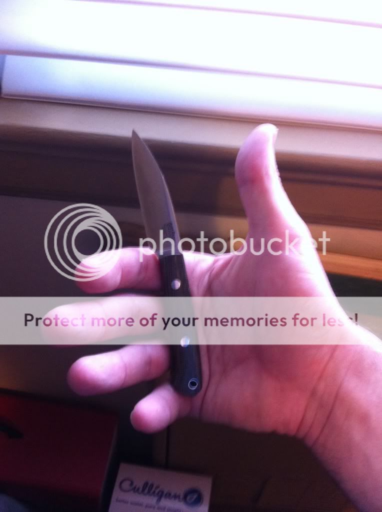

The Little carver for me is a very useful knife to test out a steel because being a fixed blade I can use it very hard, and in the sheath it's small enough to fit in my pocket. So I can use it allot more than my large INFI choppers.

I know that this is not a very scientific test, but it's pretty revealing for me that this steel, especially on a convex edge platform is a superb combination. I have done similar tests with different steels, and this one is by far the winner. This may be due to the convexing of the blade, but after the amount of cardboard that I cut for there to be no chipping I am very Impressed.

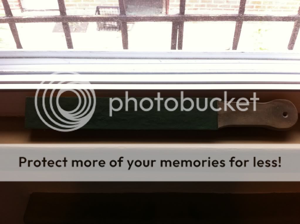

DLT Trading, their Double sided strop is great, ingeneral all their Strops are top notch, I use the Black and Green Bark River Compound

How do you apply the compound? My last question, I promise. :)
Also, if you live in a hot and dry climate (or don't use it very often) the compound can dry out a bit. Just use a very small amount of mineral oil to help you work in into the strop in a uniform way, if needed.
Ask as many as you like, out of the box, I warm up the new leather with the lighter, just running the flame over the leather quickly to open up the leather. Then I warm up the compound with that lighter, just the tip, and as people said apply like a crayon, when it gets harder to apply I warm up the compound again with a lighter. After the entire surface of the strop has an even coating I run the flame all over the compound to set it in.
Ok thanks guys. I have a home made strop and some cheap lowes green compound, but I don't think it works nearly as well as a real strop with real green compound.
It doesn't apply evenly, at all. If I rub it to try and work it in it just flakes off. Also I think the nap of the leather is just a little too course.
I'm ordering this set today, so I'm ready to see what quality components can do for my edges!
Heat up the leather with a hairdryer or something similar and you can heat the end of your compound with a flame and it will penetrate better and not tend to flake off.
